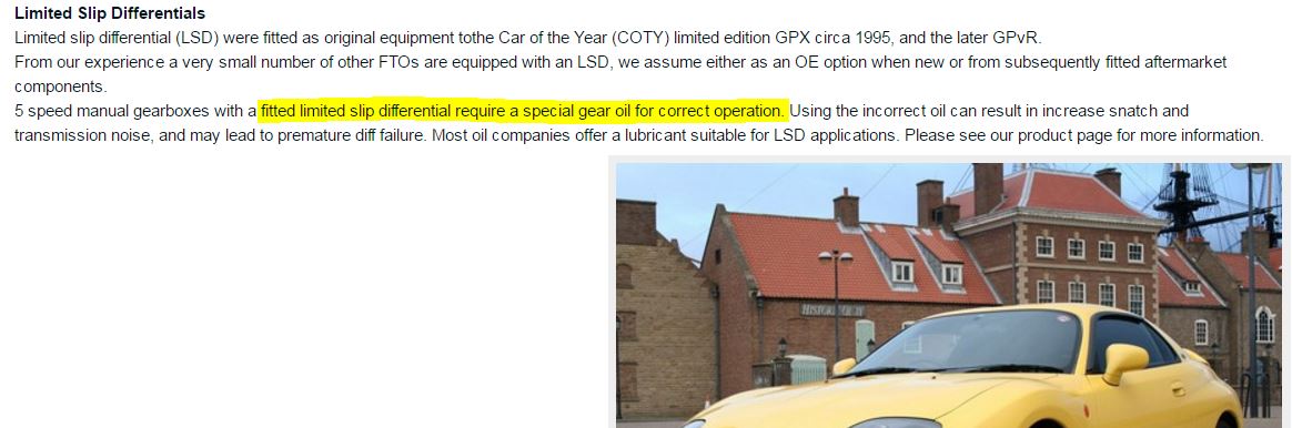

http://www.spmotor.co.uk/mitsubishi-fto-transmission (See screenshot attached)
this website suggest transmissions with LSD needs special gear oil..
I know my mechanic just chucked in generic ones in there. Seeing the sub model of the car they wouldnt have known I swapped the transmission from GPvR..
Can anyone please shed light on which exact oil I need?
Cheers!!

Re: Bottom of engine/gearbox knocking against cross member
Pretty sure the GPvR helical diff just takes standard oil. No fancy stuff required.
