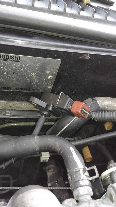

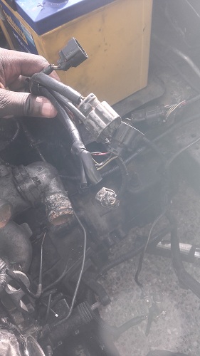

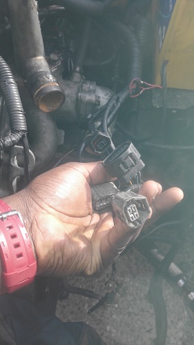

This are what have been talking about. Got one plug to the gearbox and the other ones have no idea where they go
- IMG_20160502_145750.jpg (45.88 KiB) Viewed 995 times
- IMG_20160502_145351.jpg (103.8 KiB) Viewed 995 times
- IMG_20160502_145720.jpg (47.6 KiB) Viewed 995 times

Which plug do I need to bridge? I got duped to thinking I got a manual loom and now trying to start the car realize it's an auto
- Posts: 23687
Re: Plugs need homes
Have a read of this: http://www.ftoaustralia.com/downloads/M ... on_DIY.pdf

Sensor near throttle body is an wps sensor
2 smaller plugs are auto gearbox input / output sensor
Bigger sized plug gearbox solenoid connector
Medium sized plug inhibitor switch.
