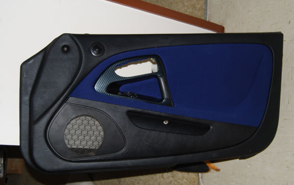

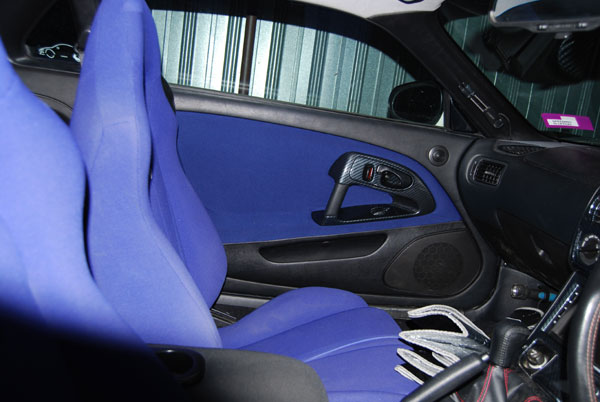

Finally got my door linings done. Had to hack them up with a jigsaw before they got covered and then put them back together with fibreglass. have fitted the front ones tonight. The rears will follow tomorrow
What do you think....

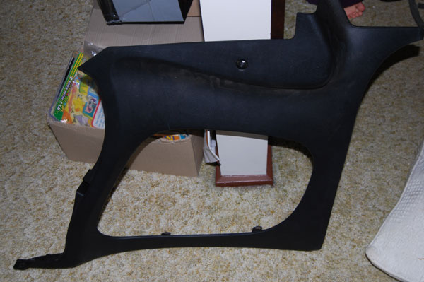

        Step 2 - Remove the door handle and the pocket/speaker cover by removing all screws on the back of the lining. Once this is done, your lining should resemble the one below (without the red)
        Step 2 - Drill a pilot hole where the red circle is marked and elongate it so there is enough room to fit the jigsaw
        Step 3 - Jigsaw around the bit marked in red. Take your time and make sure you stay in the valley. As you are not recovering the outside bit is is of the utmost importance not to damage that bit.

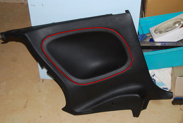

        Back panel
        Same process applies for the back panel. The picture below shows where to cut (Again, take your time). The pilot hole is a little tricker on this one as there is no spot that is going to be hidden by a cover, so it has to be neat:
        OK, youve cur out the bits, now you have to tidy up the edges. Make it consistent and take your time. The more time you spend getting this right, the better the result.

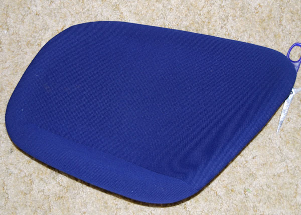

        Upholstery
        I cant tell you how to do this bit, but source your material and choose an upholster and drop the bits off to be done[/b]

        OK, this bits a little tricky. You need to put the bits back together and mask the join (covering all material. The idea is to fibreglass over the masking tape (it works a treat). Make sure thatthe bits are aligned with one another properly as once its set, there is no going back.
        Step 1 - Cut strips of fibreglass about 8cm wide and long enough to fit. Do NOT fibreglass over any of the screw holes. Mix the fibreglass and apply a bit at a time. I found that as the join is not flat, my fibreglass kept lifting and I had to keep pushing it down again. On the back panel this isnt so important but on the front panel, there isnt a lot of clerance. I actually have to shave a bit of the fibreglass off on the top of the front panels as protrudes a little too much. I dont anticipate that this will be an issue though.

            Is the color a perfect match, as in the pics it looks ever so slightly off?
            Also, what did the door trims look like stock?
