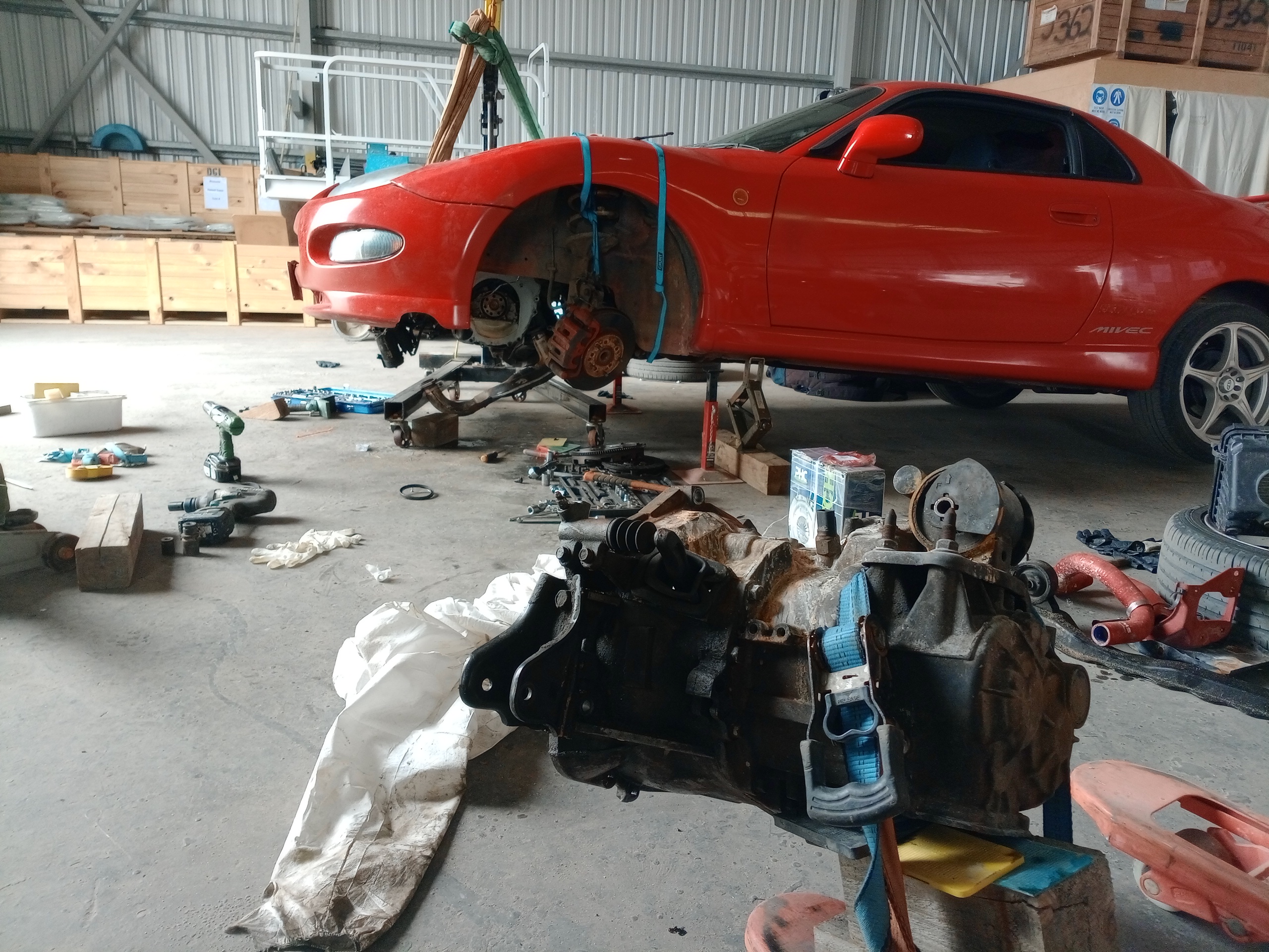

Re: Clutch Change
Thanks for the steps.
I just changed my clutch.
A few details to make it easier.
You can leave the engine mount on the other side from the gear box on, and undo the mount above the gear box.
Tilt the engine down with a crane coming in the side of the car on the opposite side to the gear box, to make way to trolly the gear box out.
I used a pallet jack with block of wood to ratchet strap the gear box onto.
Wedges are useful to hammer in and align the gearbox tilt with the engine tilt.
I managed this job solo using these steps.
