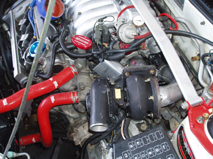

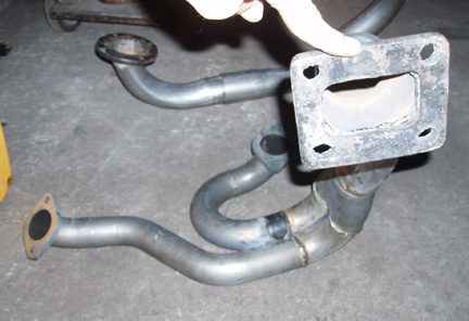

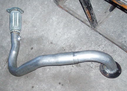

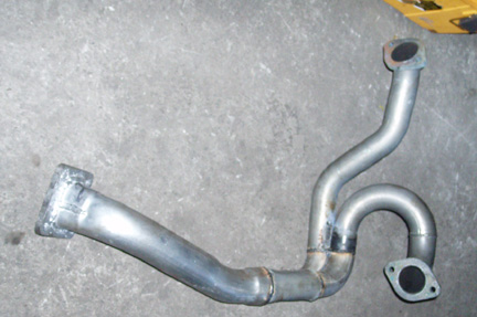

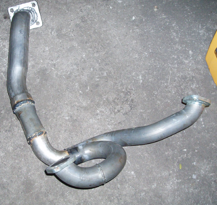

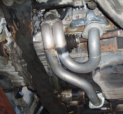

Hey guys and gals....got my project more or less on the coming to completion side...at least from a mounting standpoint. Up pipes and downpipes should be fitted 2morrow but gave me hell because of having ABS the space is very restrictive. Anyway here are some pics of them before they go on the car..
The uppipe is basically RPW downpipe/hacked and a couple pieces added on.
So far I have
Turbo
Intercooler (big 24x8x3)
Silicon Bends for intercooler piping
HKS BOV
5.8psi TurboXS Wastegate
Standard Injectors (should cope for the time being)
Greddy e-manage installed and waiting to be tuned
Oil Lines for turbo feed and return
Exhaust piping as shown.
Getting top piping on exhaust heat wrapped 2morrow and sump tapped for oil return.
Trying to find out maxximum pressure capability of the MAF sensor so I can know if to run it as a blow through instead of suck through setup..
