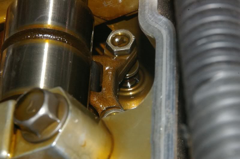

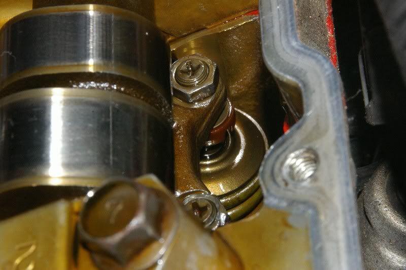

3. Take them to a mechanic, who even though they don't know about the car would still be able to do it, but then not adjust the gap correctly, and you may have to supply an engine manual to them.
4. Or you could take them too.......ahhhhh.......can't say where. Somewhere around Castle Hill know a thing or two about these cars (but they failed to notice that these two were missing off my car
