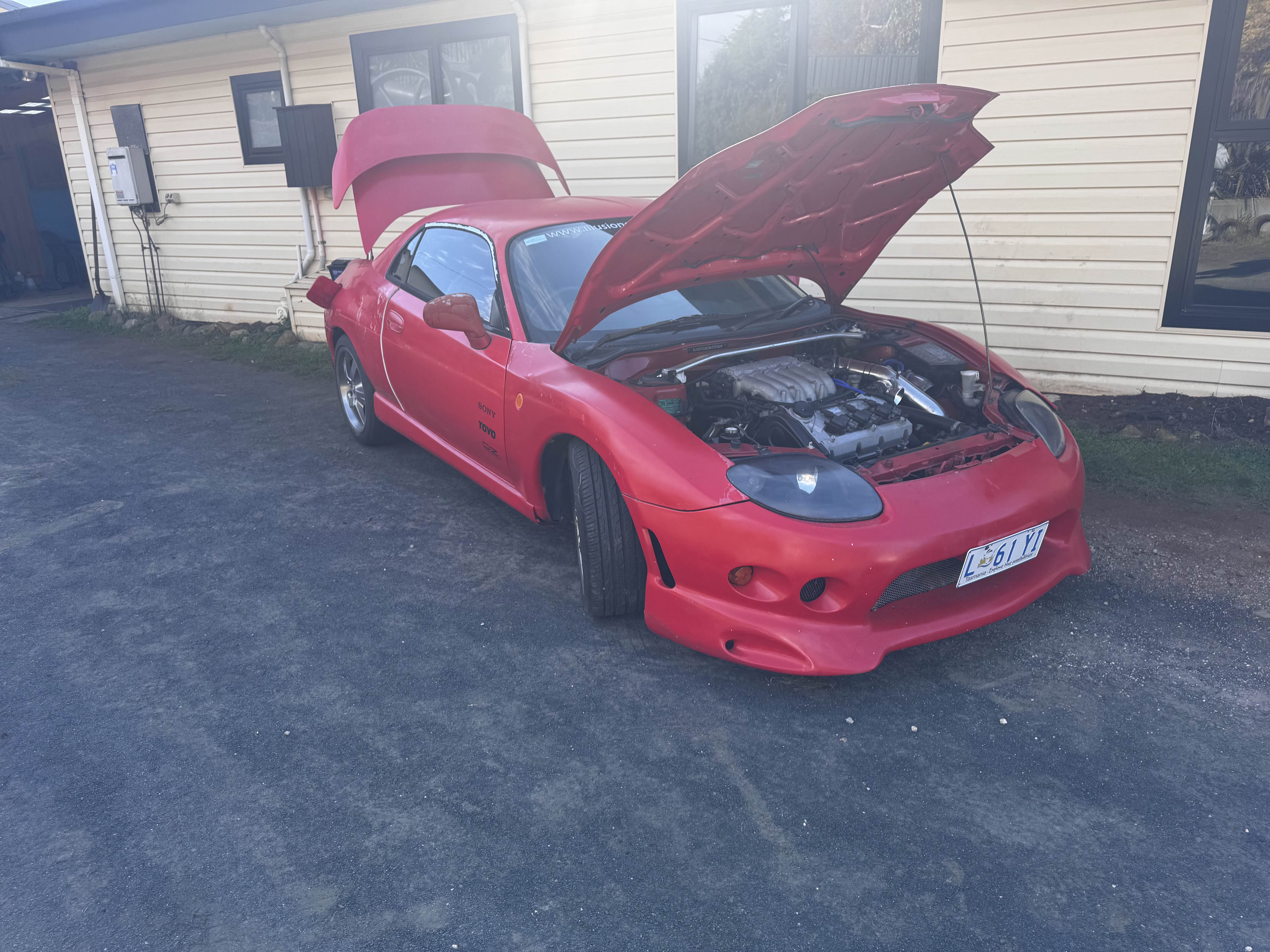

Good morning those who still roam this forum haha,
I have just picked up GPXXX's infamous 6a12 mivec turbo 5 speed. Has shared many regos/names (was KLABAT in victoria).
I understand she had a bit of a following back in the day, if anybody has any information of her past condition (may have had some mechanical issues a few years back) that would be great!
If anybody has any questions about her/how its in my hands feel free to reply.

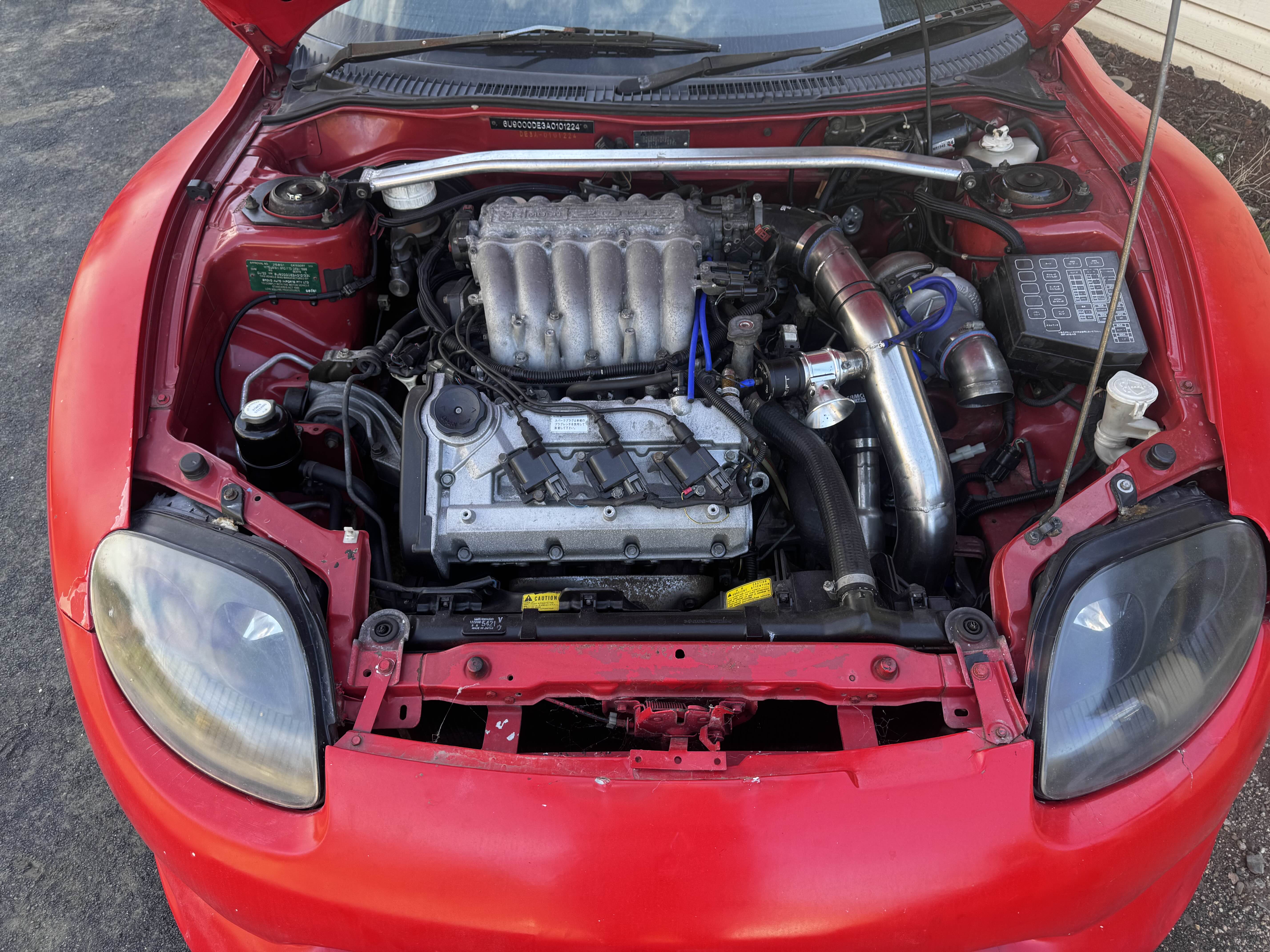

PROBLEMS with the old girl:
Oldschool microtech piggy back tune has corrupted. Am waiting to hear back from microtech (if their email is still manned) to see if this is a reinstallable fix. If not I have already got the plans and budget to do a piggyback haltech 2500.
I have plans to rebuild the motor with stronger internals, as the gearbox has been rebuilt to handle more power, the only thing holding this beast back from 250kw is the internals. I have a new T28 turbo currently installed on her, but I have the original big boy garrett which was removed due to engine explode-related concerns. As of now the fuel pump is good to support up to 400hp and the injectors are 480cc. The turbo is rated for up to 450. I think I wouldnt want anything more than 350hp being a FWD lightweight car.
I
I

The plate and name didn't ring any bells, nor the engine bay, but as soon as I saw the front of it I remembered it
Poor thing is looking a bit worse for wear! (but aren't most of them, mine included lol). But doesn't look as much as basketcase as some I've seen recently. I'll see if I can dig up some pics of it's former glory.

Re: GPXXX (Mikey's) FTO found & purchased.
Update, have got the microtech software (it has a Microtech LT8X-S) and have just ordered the adaptor so the software will work (200 dollars later in 1m of cables)
Currently she does not idle, will start and immediately choke due to fuel. I believe the microtech has corrupted (i believe not for the first time)
Unfortunately microtech doesn't really exist for support/tuning anymore. I have a shop in tasmania that is going to have a crack. My hopes are that I can get it to run, and then I will do a full rebuild with RPW internals and a haltech Nexus S3
Update, narrowed it down to being purely ECU related for no startup. Got a shop updating the old girl to a MaxxECU SPORT in september. It wants to start so badly. Will be getting her to run on a base map & then rehoning the engine with 0/25 oversize pistons & forged rods before making serious power.

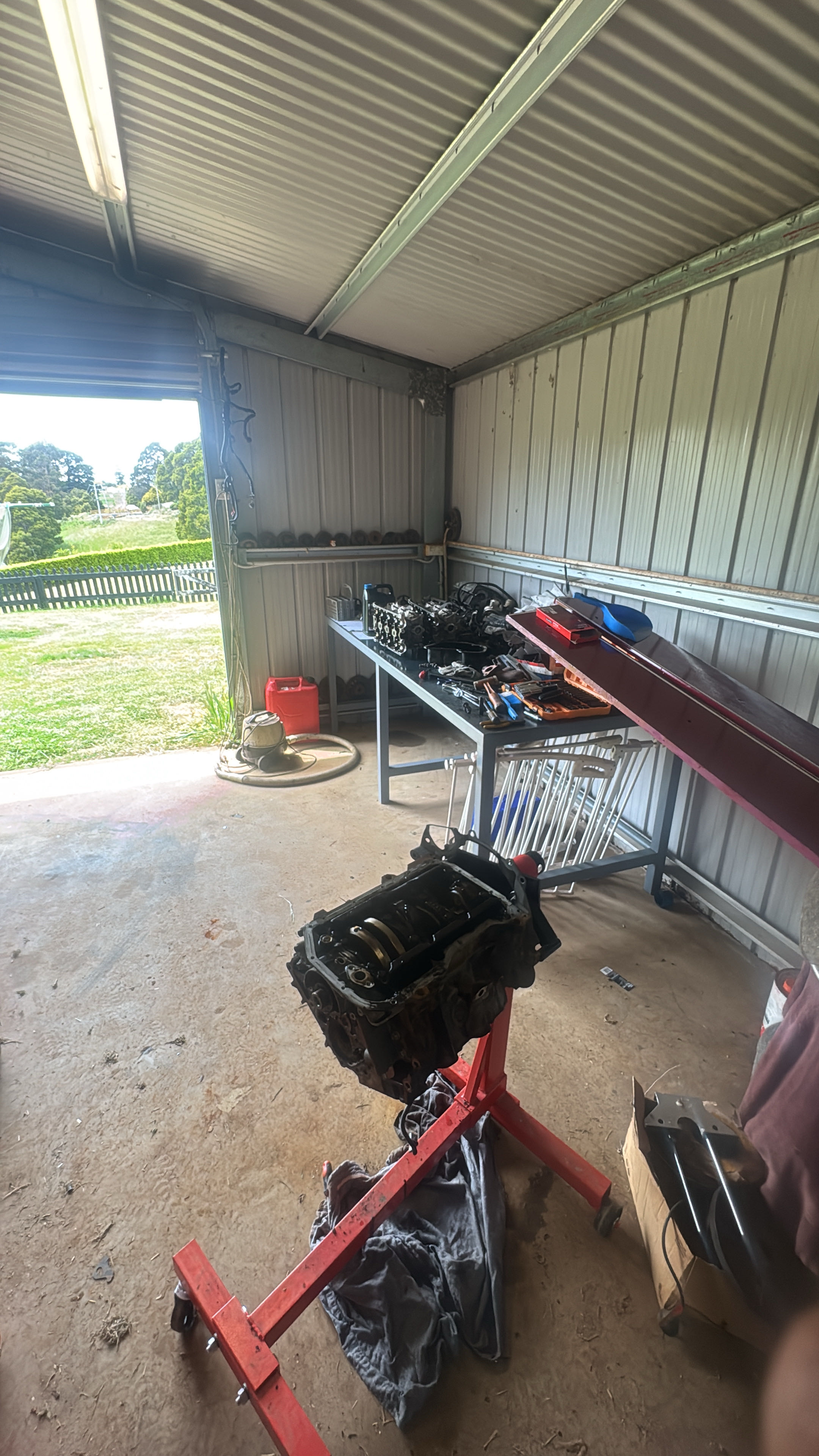

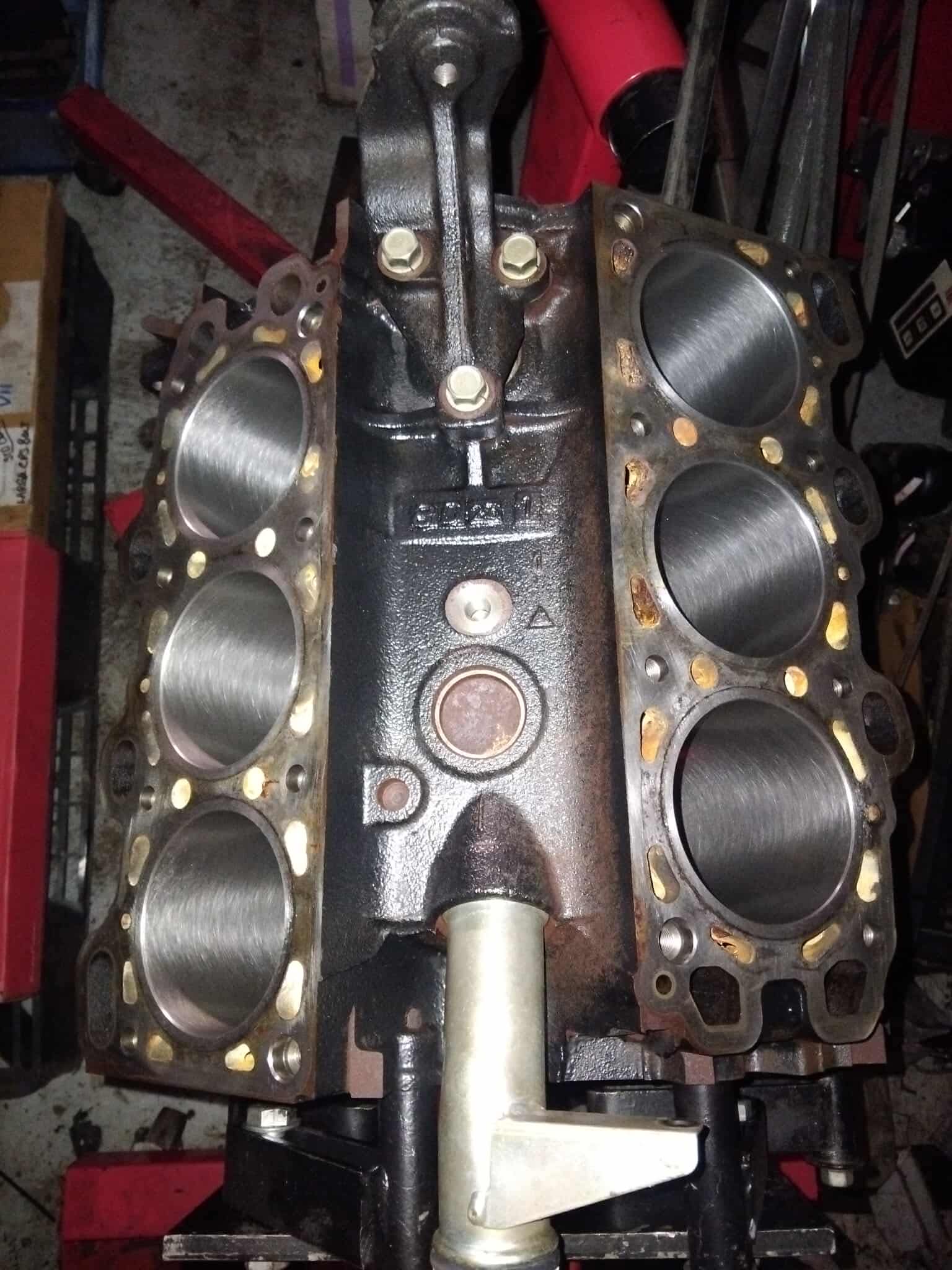

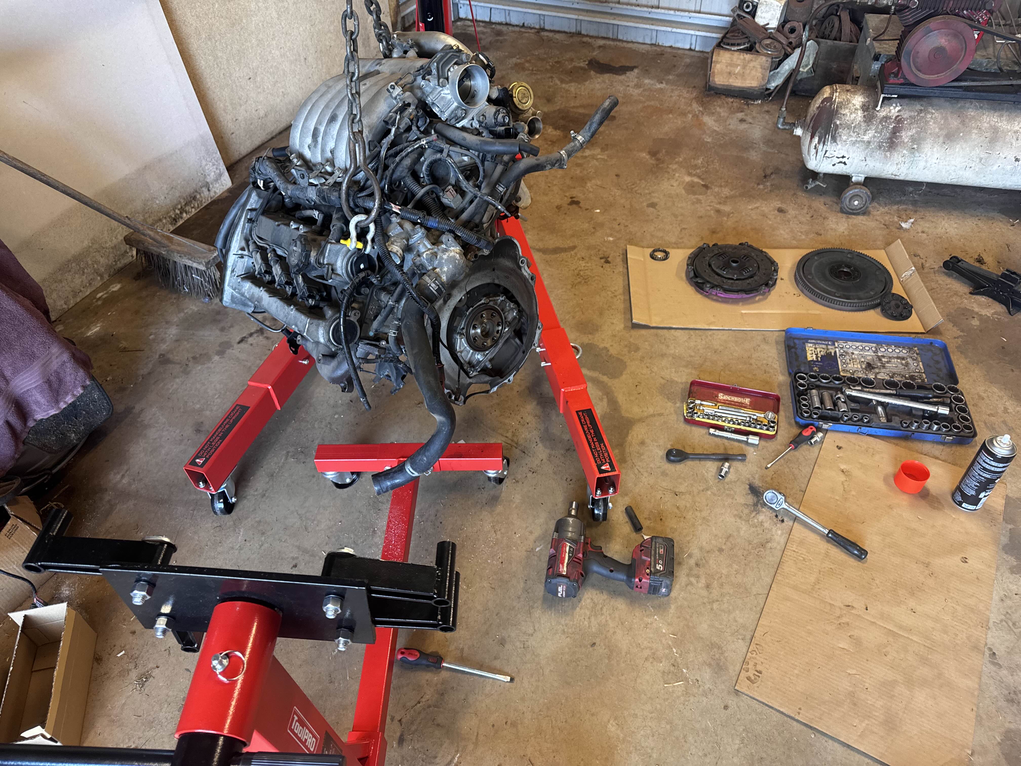

Update, FTO is still at the shops getting the ECU & DBW conversion. Am having a meeting with them this afternoon to discuss the work on the girl (no point in doing any mods to the current 6a12T in it when i'm swapping to the 6a13tt.
On the 6a13tt, heres some photos! Not in order but theres the complete engine on a tyre before dissasembly, then the engine pulled apart on my workbench I made just for the job!
So... there is one issue. When taking off the water pump, quite a fair bit of black/brown water and gunk came out. What was behind it though is extremely rusty and it looks to be quite deep rust. I've brushed some out and it just looks terrible in there, and considering it's in the middle of the engine & I am trying to make some pretty extreme power numbers out of the build I don't think ill be using that block.
GOOD NEWS! I previously mentioned I bought two engines, the one that was incomplete and already pulled apart, and the one I've pulled apart just now. The block from the incomplete engine is the photo of the block by itself. It looks very good & was from a motor that did a valve. The water pump on this one was dry stored and all thats left is some coolant dust. I will be using this block pending an assessment from a engine specialist.
I have an order ready with RPW (WA company, im sure you guys are familiar) for everything needed for a forged rebuild incl heads and cams. I am trying to get in contact with them beforehand to see if they would offer some sort of discount considering it will be over 10,000AUD & I would be open for advertisement.
