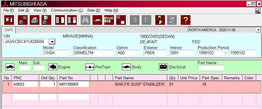

EDIT: Got one. Looks like it's from a DE (base model), and I verified ASA with a VIN, and it looks like perhaps it's an 18mm here in the States? Shop guy's gonna measure for sure once they pull the piece.
2021-01-06_Mirage Swaybar_ASACAPS.JPG (76.65 KiB) Viewed 17609 times
This is where it gets dicey. Finding which trim has a 20mm variant. For instance, cross-checking online DBs like Amayama's, Megazip's, and mitsubishi.epc-data.com (because I'm lazy and don't have other VINs) tells me that most 5th/6th gen Lancers and Mirages can have 18mm or 16mm ones. Ironically, the top-trim GSRs from JP have 16mm front stabilizer bars part number MR223855 as listed above. MR MIVECs (CK4A) have 16mm!
So, here are the various part numbers I've come up with
  • FTO all else 16mm - MR131542
  • Lancer / Mirage 16mm - MR223855
  • Lancer / Mirage 18mm - MR198869
  • FTO GPvR 20mm - MR333830
  • CP/CN Evo 23mm - MB856409
Really tells you how "special" the GPvR is. Silly - that rarity creates such value. Like how ammo costs so much in the US these days, thanks to politics. Never mind COVID.
In this case, I'm finding that the GPvR seems to be the only one I can find that has a 20mm sway bar. Everything else might be a Goldilocks story - too soft, or too hard. A Lancer with a 20mm sway bar is just as rare, it would seem.

just measured mine and cross referenced the bush part number. it is 18mm sorry but hey its an option :)
