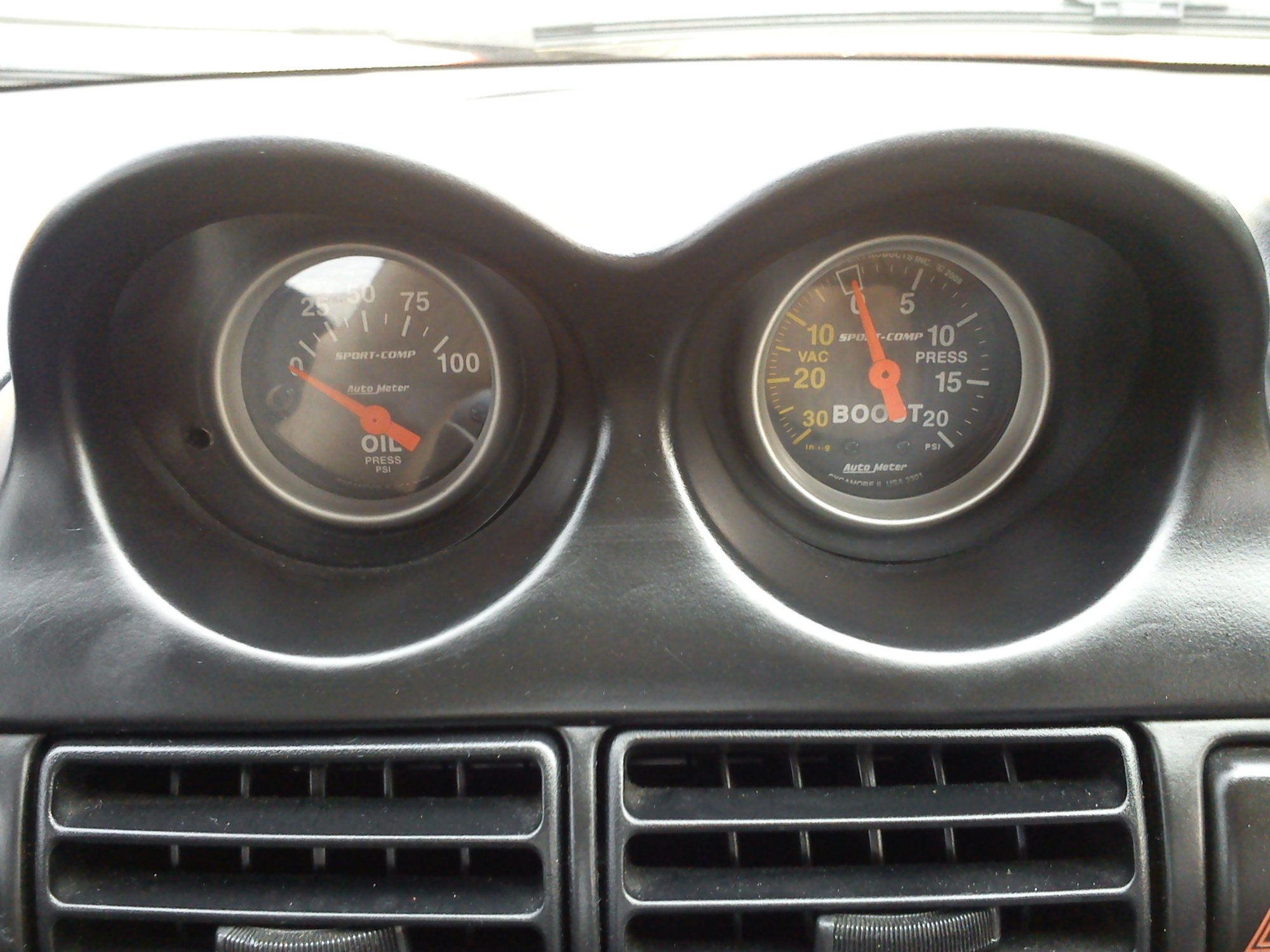

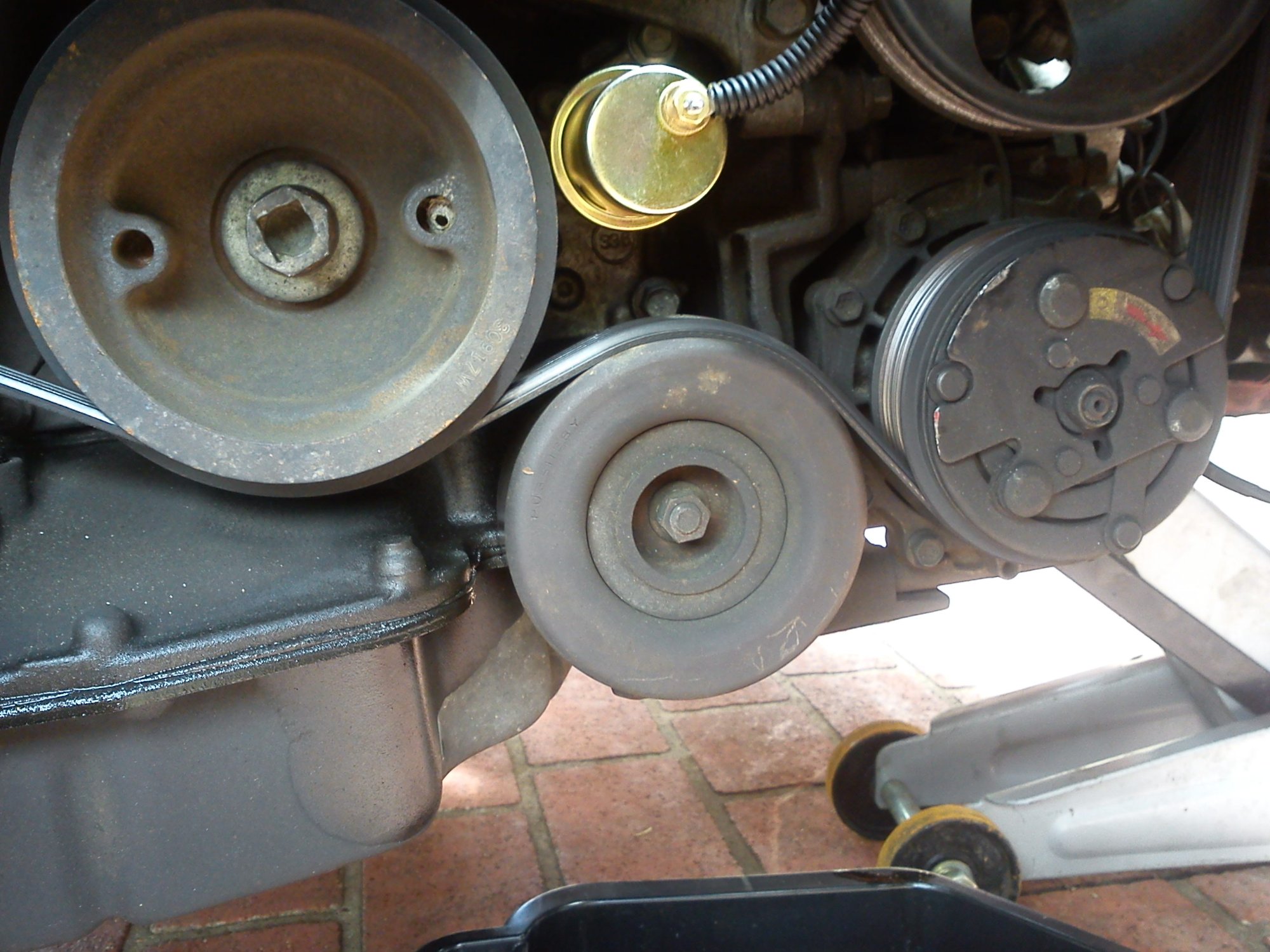

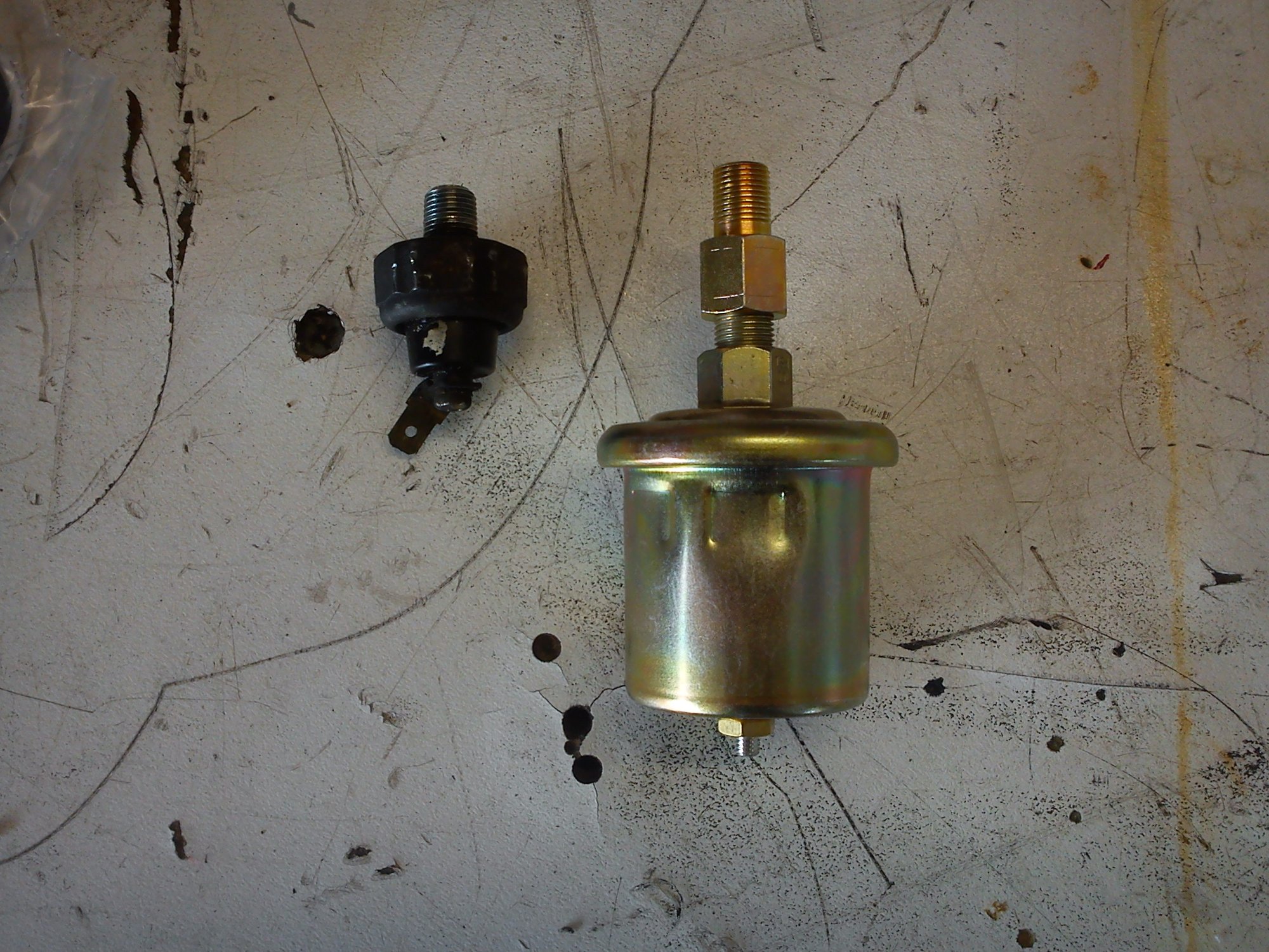

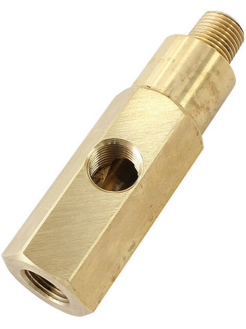

You can just use one of those brass 2 way adaptors & plug straight into the oil pump where the factory pressure sensor is.
I went with the Autometer pressure gauge (which have that massive sender unit), but the same principle would apply. You could run the factory temp & pressure sensors in that sort of set up. Most of my experiences with sandwich plates have been a leaky pain in the ass that, as you say, take up too much room.

The problem lies in the fact you need the factory sender. The gauge and sender need to have matched resistance values. So your readings are most likely going to be wrong if you use anything other than the factory sender.

Thanks for the info and pics Bennoz.
Think i will use the same location you have used for oil pressure.
