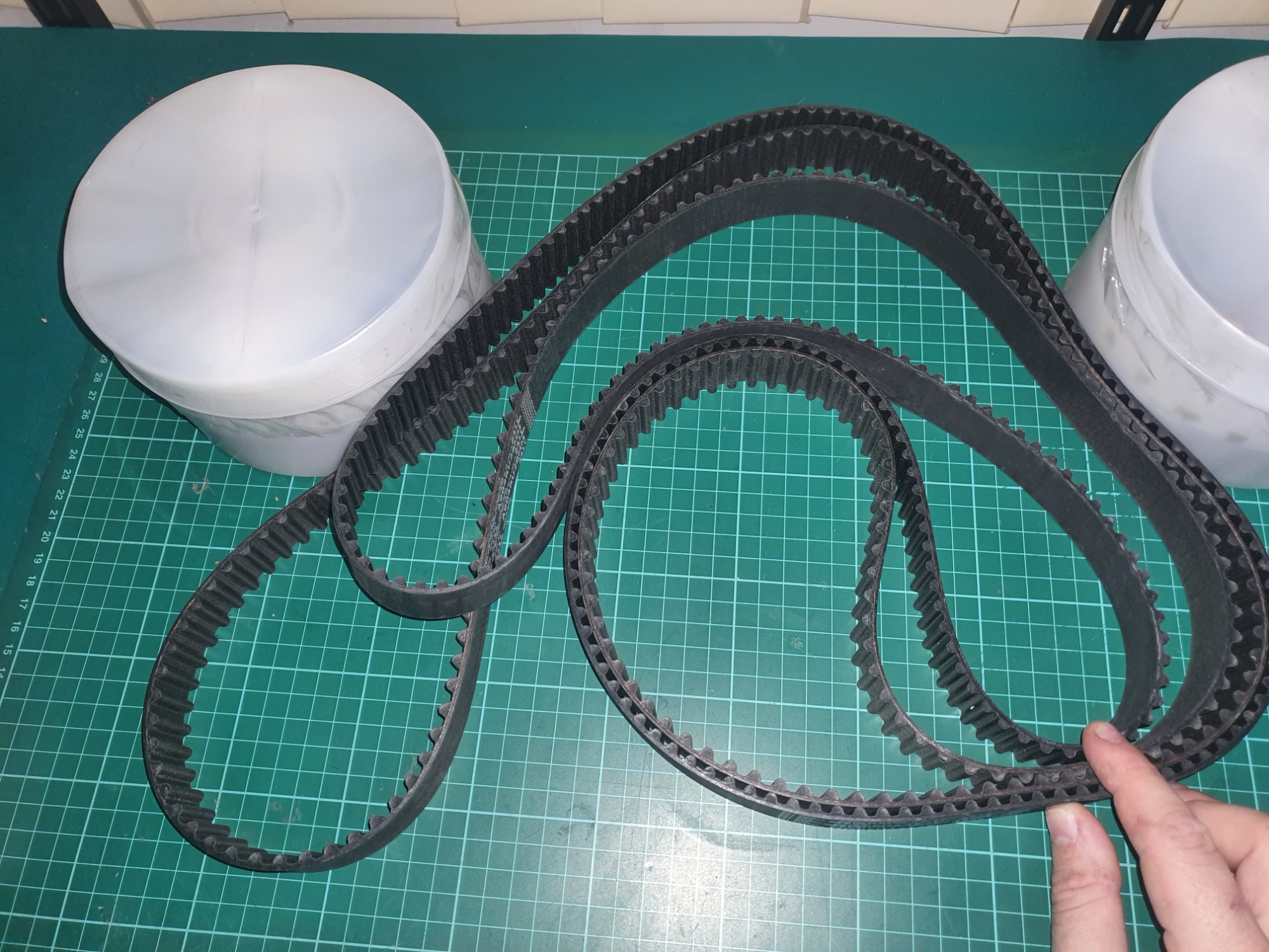

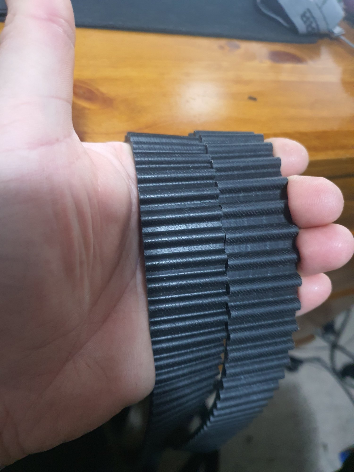

Posts: 3955
Re: 6a13 na mivec
spetz wrote: ↑Thu Mar 12, 2020 7:51 pm
Vectose wrote: ↑Sun Feb 16, 2020 10:35 am
spetz wrote: ↑Fri Jan 17, 2020 1:04 am As for the timing belt, my research has suggested that a Honda NSX timing belt will fit.
NSX belt doesn't fit. The tooth spacing is a lot wider and makes for a much longer belt.
Are you sure?
From memory it was the same, the only difference being that the NSX belt was 28mm wide rather than 30mm but I could be wrong.
Either way the timing belt isn't an issue here as we see the idler pulley in the V valley can be lifted up with spacers to accommodate the extra deck height
Here we go. Pulled out the NSX belt. Showing the wider tooth profile as well as the length difference.

Wrong again. You use the 6A13TT 234 tooth belt.
