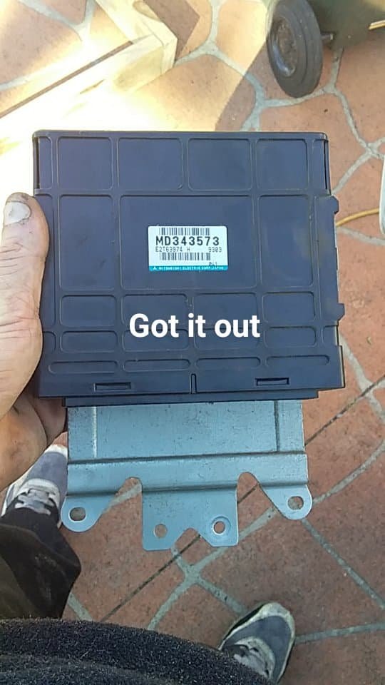

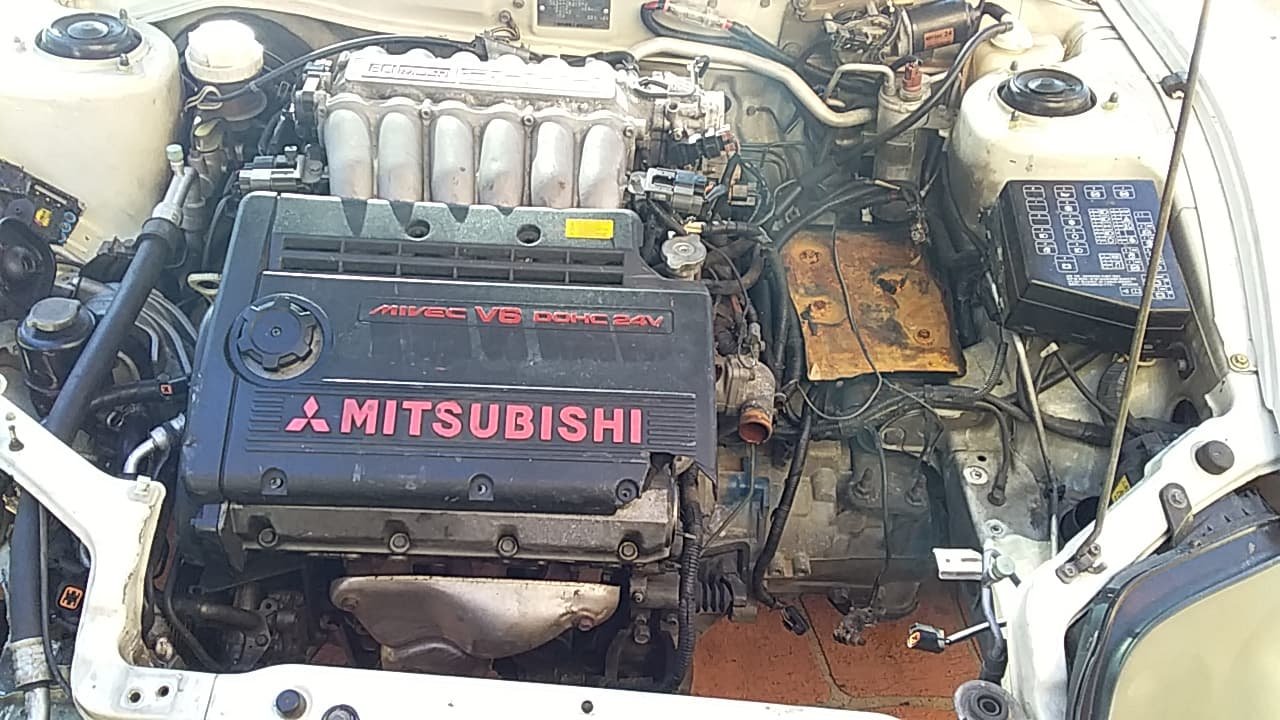

Maybe, because the guy I sold it to said he looked it up and it's a non mivec ecu so I was just confused myself as to how it was working
here's the ecu and car

- spetz
- Posts: 2915
Re: Non mivec ecu in mivec ?
That does seem like a non-MIVEC ECU judging by the part number.
Perhaps it was reflashed?
But from my understanding it is impossible to reflash AFM based Mitsubishi ECUs to run MAP
- Posts: 3955
It's a GX ecu. Plastic case means it can be flashed.
He isn't running MAP, still running MAF. Could've been reflashed to set one of the outputs for MIVEC.

Mivec swapped gx
- Posts: 99
- Joined: Fri Dec 22, 2017 3:06 pm
Yeah i done an engine swap from my mates uk gpx engine to the jap engine in the gx and I realised the mivec solenoid s weren't plugged in when it was in the gx I plugged them into the gpx loom and when i drove it it went way harder than it did in the gx, it also went way harded than the uk gpx engine. Anyone know how it would of gone harder and felt like mivec kicked in better than the gpx engine with the mivec solenoids not plugged in
Just the jap engine out of the gx and the one out of the gpx, my question was why did the one out of the gx go harder than the one that was in the gpx when the mivec solenoids weren't plugged into the gx and they were in the gpx and why did it feel like mivec was kicking in if the solenoids weren't plugged in.
The 2 plugs connected to 2 wires that run straight into the engine are the solenoids right because that's what wasn't plugged in
