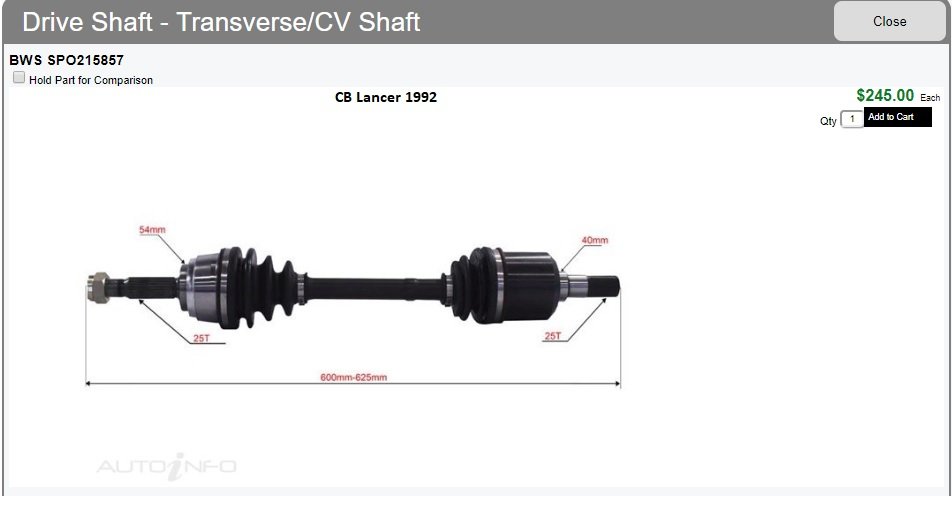

Post by Rob Furniss »
Looks like you're right Ben, need to get further measurements though and find out if the spider mechanism the same?
CB Lancer 1992 driveshaft 25T.jpg (29.66 KiB) Viewed 11149 times
These are right ones

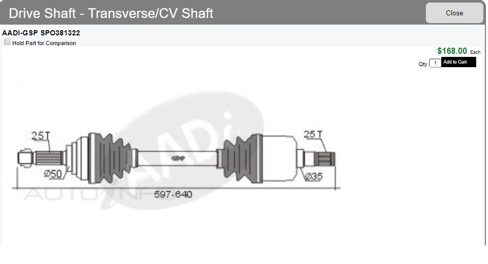

Looks like this one is different size though
CB Lancer 1992 driveshaft 25T different size.jpg (29.89 KiB) Viewed 11149 times
Re: LSD - how much will this benefit me?
Can you buy just the inner cups? Then transplant the rest off an FTO...

Cups on their own seem to be just outers not inners, a gearbox/driveshaft shop may be able to source them though.
Rob Furniss
Posts: 1394
Location: Perth
Looks like Galant GSR 1988 to 1992 also and the inner CV's are PBT85 from Protex
CC Lancer 1.5 SOHC carb 65kw also use PBT85 inner CV's.
