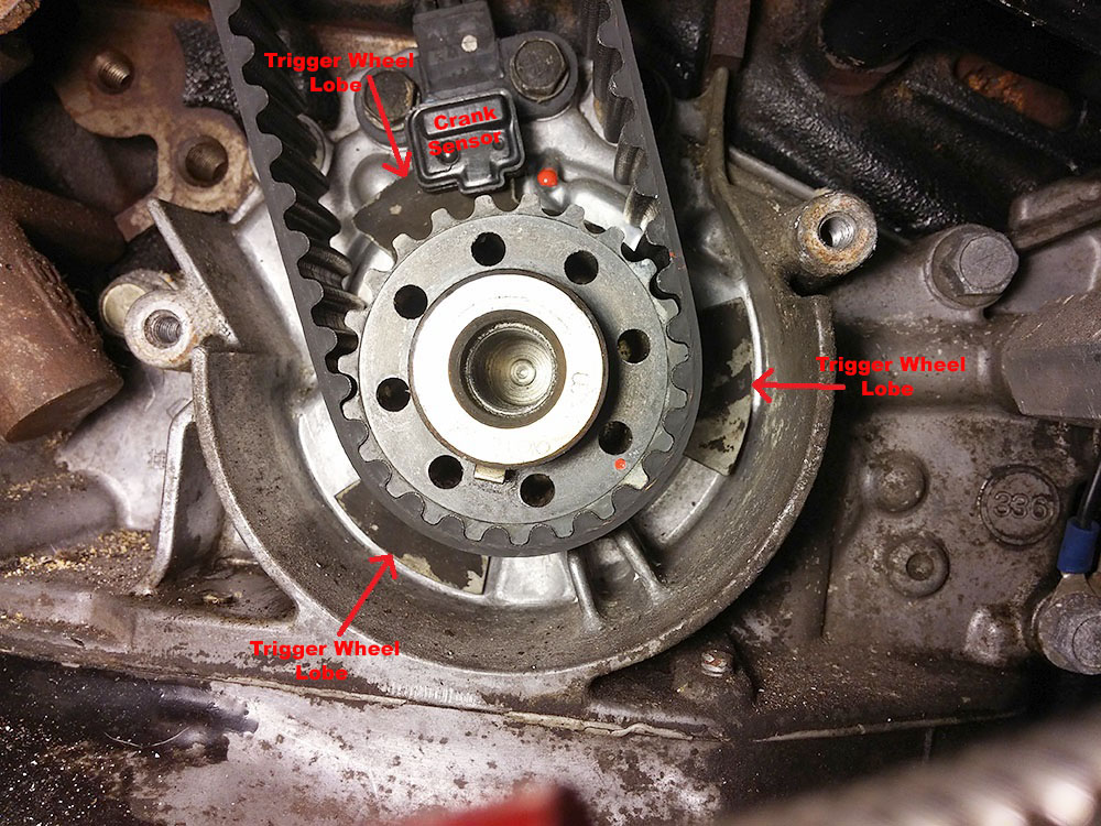

For those of you who have fitted a standalone ECU how have you told the ECU the ignition pattern from the crank trigger wheel? I have a 6A13TT FTO which I have had up and running on an Emanage Ultimate but had too many issues with it so currently switching over to a ECUMaster EMU standalone.
For those who havent seen one before the crank trigger wheel is behind the pulley here and has three large lobes on it ...

Depends on EMU it may only require 1x trigger so removal of others required,

Yep, I ground mine down, only left one tab for Haltech.

On the crank? I left all 3 on the crank and just ground down 3 off the cam.Bennoz wrote:Yep, I ground mine down, only left one tab for Haltech.

I would assume the Haltech that these guys are running only needs one reference point running past the crank angle sensor.

Needs one on the cam sensor. Crank stays the same.

He's quite right though, I was thinking cam sensor. V6 Mitsi engine need a minimum of 3 tabs, to indicate the 3 possible crank locations for a wasted spark system.

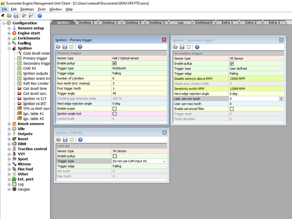

I'm getting my head around the trigger wheels now, i just need to select the right options in the software as its asking about falling edge and degrees, etc. I'll post a screenshot up, you guys might be able to point me in the right direction.
I can play around with the mapping side of things but this primary ignition thing is something i need to get right before i turn the engine over.

Heres a screenshot of the EMU software I am using, it allows you to select all kinds of different options from number of teeth to angles, etc ...
The primary trigger is the crank and the secondary is the camshaft. I understand how the crank sensor works but dont understand why I need to cut the lobes off the cam sensor though
Would one of you guys be able to screenshot your ignition options you have chosen so I can get my head around it?

Yes you keep the larger tab and cut off the smaller ones.
