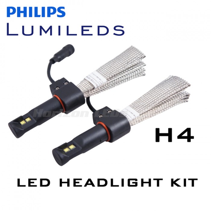

I played around with some LED headlight bulbs a couple of years ago. I think they have potential. I couldn't get the light to focus properly as the point on the 'bulb' where the light is emitted is in a different location to the filament of normal bulbs. They have large heat sinks at the back, so I had to move the power steering fluid reservoir slightly to accommodate them.

I've gone full LED SMD and played with the LED units in the projector housings - they're not there yet. At least the heatsink is flexible and hides inside the housing - it's a squeeze, but doable.
Stick to Xenon be it D2S (OEM) or aftermarket as the light output is considerably better. The tech is getting there, but not suitable as a retrofit.
