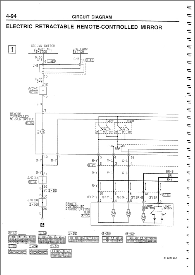

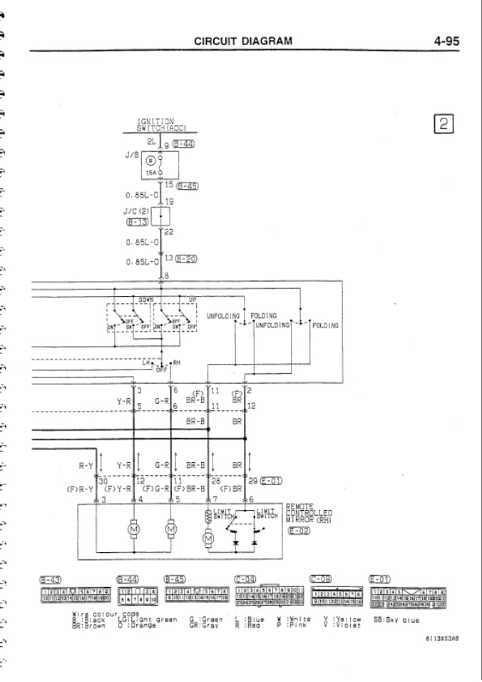

Mirror switch wiring diagram..
Where the bloody hell is it?
Re: Mirror switch wiring diagram..
Here it is :D
Electric Mirror 01.jpg (218.84 KiB) Viewed 567 times
Electric Mirror 02.jpg (189.41 KiB) Viewed 567 times
