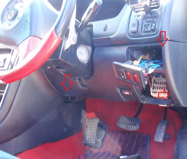

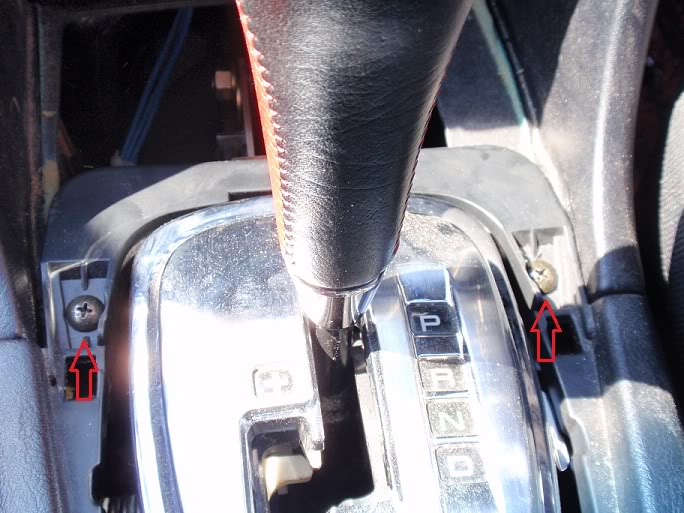

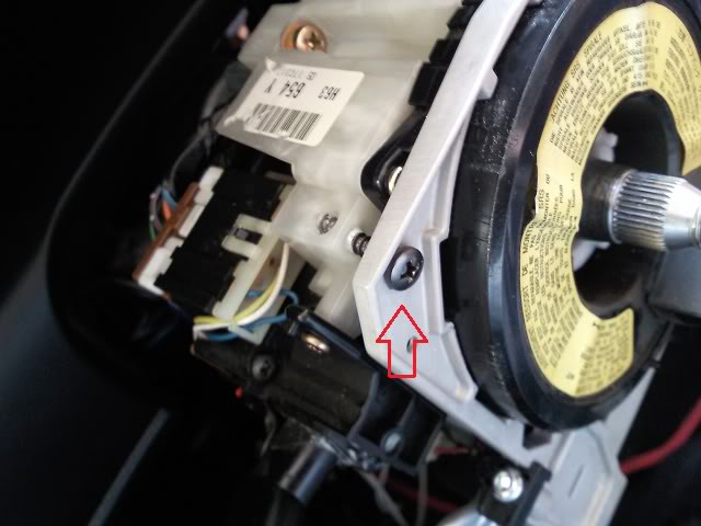

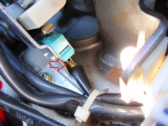

For the next few things you'll have to remove I've taken pictures & marked the bolts/screws with red arrows:

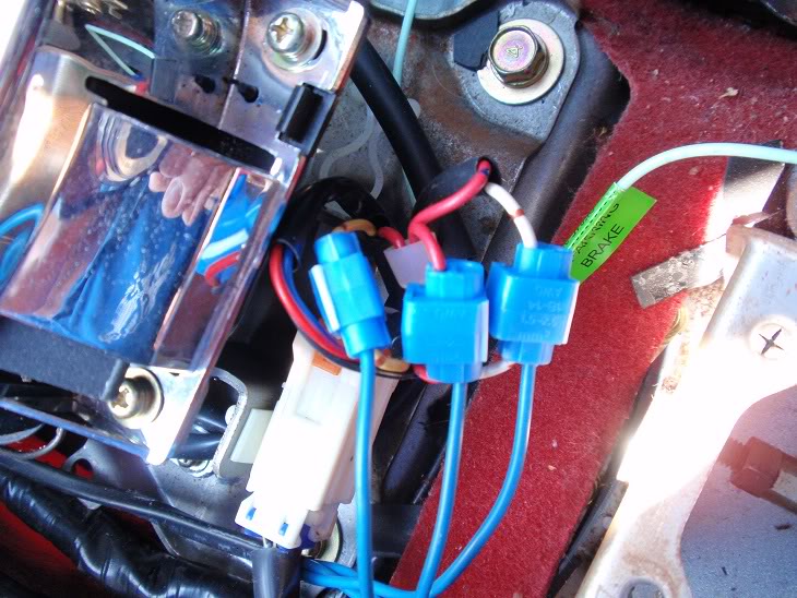

Take off the whole centre console and underneath your tiptronic shifter you'll find this:

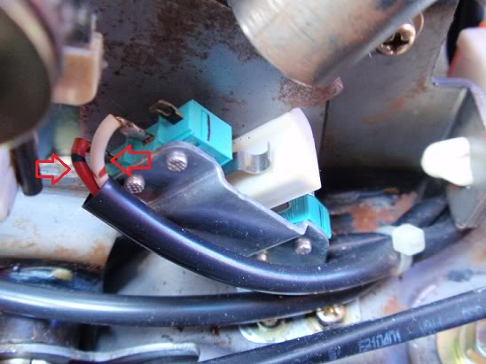

White cable is gear up, yellow is gear down, red is +
Tap your 3 cables into the existing white, yellow & red cable, once you're done it should look like this:
Important, remember which cable is which

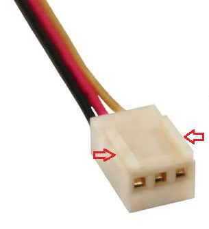

Now get your 3pin fan cable & shave of the 2 little bumps on it as shown here:
It'll will perfectly fit into the Evo X paddle shifter plug!

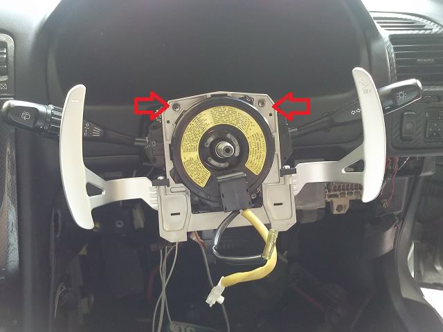

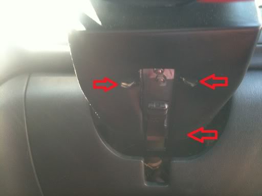

Now it's time to grab the awesome paddle shifter, take off around 1mm with your file from the inside & constantly test if slides over the steering column like this pic shows:
Get out the cordless drill with your 2mm drill bit and drill 2 small holes in the same direction as you can see in the picture above on either side. Take the 2 screws and attach the paddles to your steering column. At the end it should look like this:

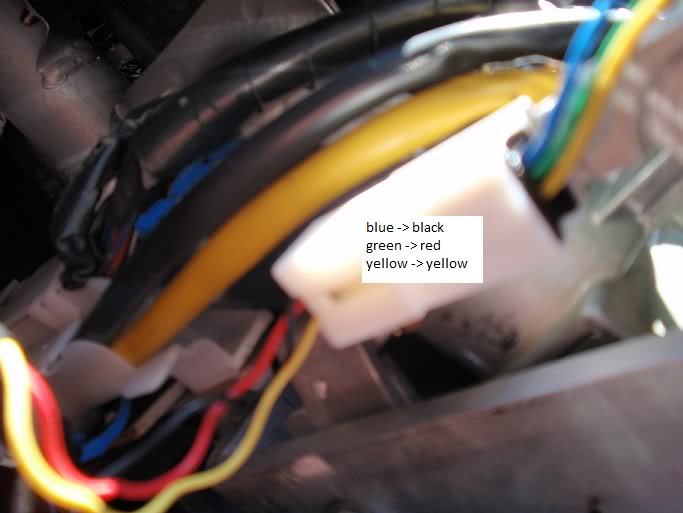

Now we've all the cabling done up to the steering column, the paddle shifter is in place... all you need to do now is hook'em up. This picture shows you which cable needs to be connected with the cables of your 3 pin fan cables
Now it's time to put everything back together, you'll realise that the bottom cover for your steering wheel column doesn't fit anymore, now it's hacksaw, drill & file time. I'm currently working on making up a new top & bottom cover that fits perfectly, the gap I have at the moment is only 1-2mm, but I don't like it.
