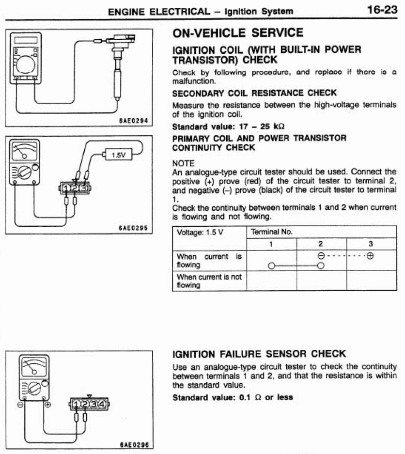

im looking to test my coil packs and see if there upto spec as im having missfire.
but i cant find the specs anywhere, been loading a fto manual for like 10 mins now, but hopefully it may be in there.
coil pack specs?

Re: coil pack specs?
thank you phil
