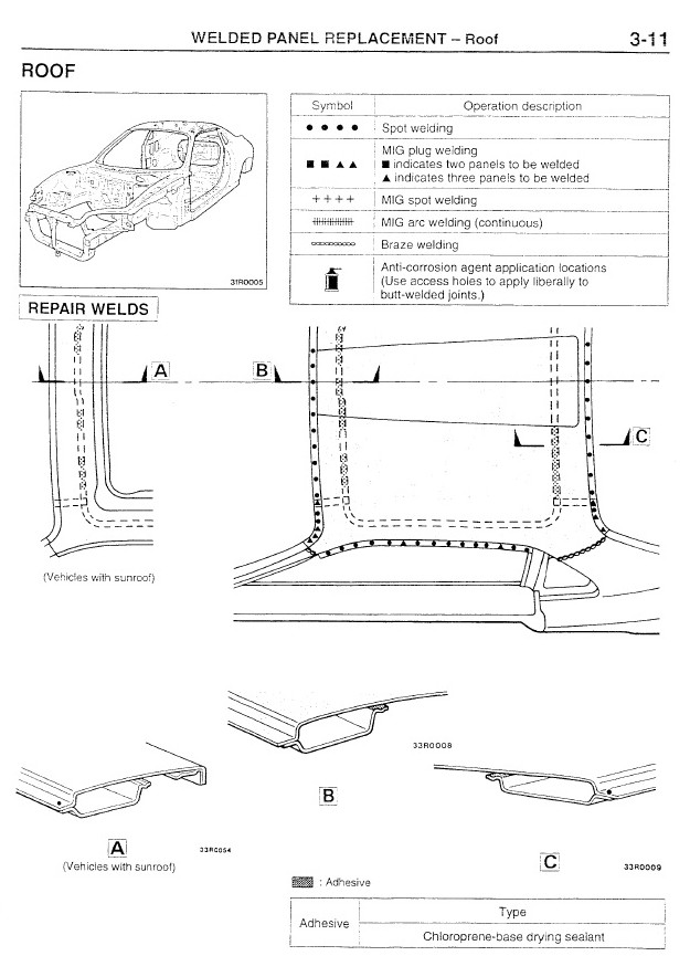

Did a search and many threads have suggested that you can buy a new roof and install it but has anyone here actually done it?
Do they actually cut the roof out (as per diagram below) and weld the new one on whilst possible bracing the roof temporarily?
Thoughts?

Gholdy had it done, it's just the skin, separate from the frame.
Shouldn't really ever cut the frame.

    I had it done to one of my older Camry's about 6 years ago they cut the whole skin off because of rust
    cost me about $1200 back then.
    was perfect when finished
    sold it to my nephew and its still perfect

    That's actually not a bad price considering the amount of work.
    Thanks Dwayne will keep it in mind if I decide to wander this way

    From quick inspection the rust only affected the sunroof itself, not the roof supporting it.
    Better inspection could say otherwise however.
