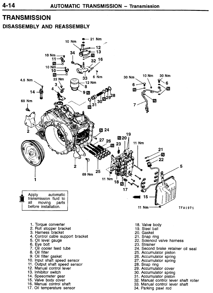

I have just been doing a bit of reading of the manual.
Workshop Manual 1 - section 23 - page 32.
Inspection procedure 12 - Some shifting points displaced.
If some of the shift points are displaced while driving, the cause is probably the malfuction of the valve body.
Pic taken from the Workshop Manual - Engine and Transmission I'm not saying that this is your issue, but you have changed everything externally so you would have to think that this is an internal issue.
Read the 2 manuals I have quoted and decide for yourself.
Go ahead and check all fuses and wiring first, but if you get to another dead end then......
