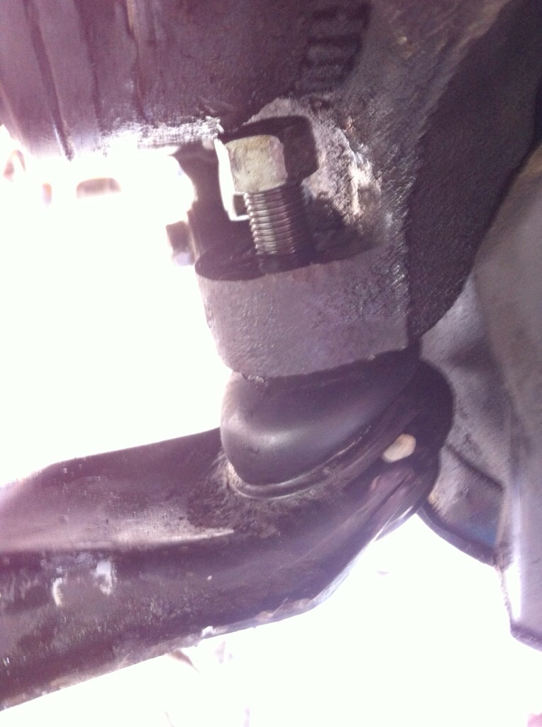

How do get this last one off? Is it ment to just drop down? I've tried bashing it out
