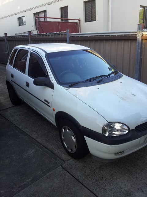

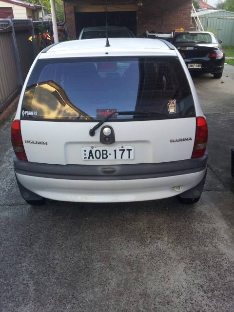

So I have added to my fleet of cars.. up to 3 now, 4 if I ever get this van...

It was given to me by a good family friend. They were just gonna scrap it because they didnt think it would pass rego and didnt have any need for it.
On startup it apparently gets up to nearly 100 degrees in temperature, then goes back down to normal operating temp. Said it was some sort of delay issue where the fan kicks in later than it should. Ideas?
