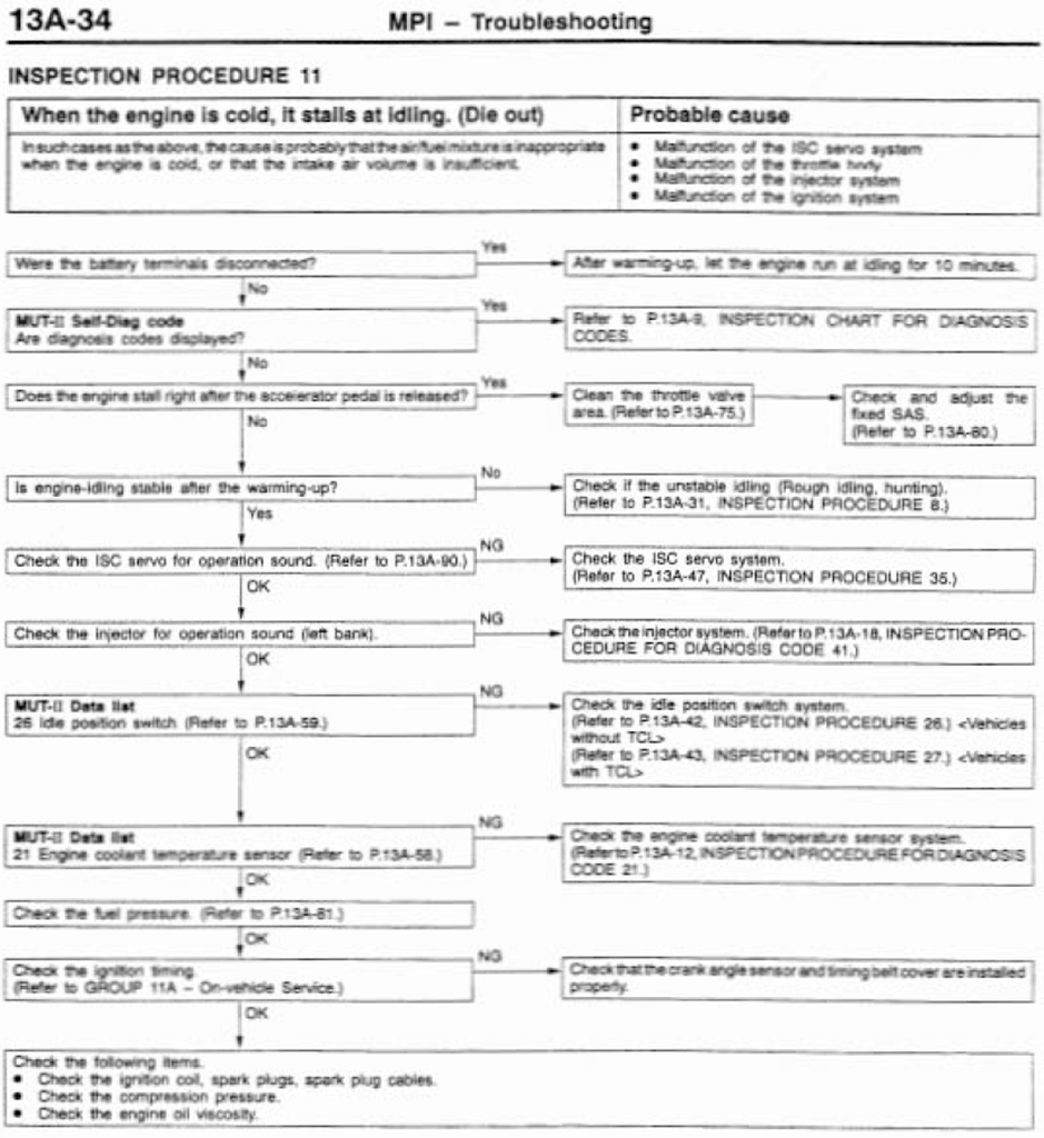

From the workshop manual...
(If you click on the pic you will see a bigger view of it)

Re: Idle problem
Hi Phil
Thanks for your reaction !!
