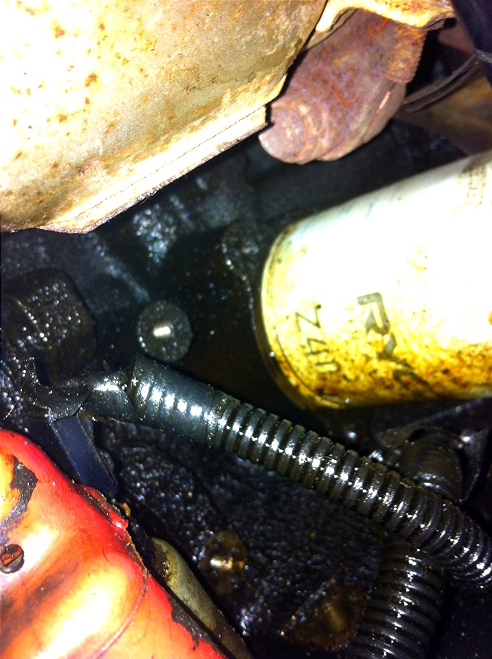

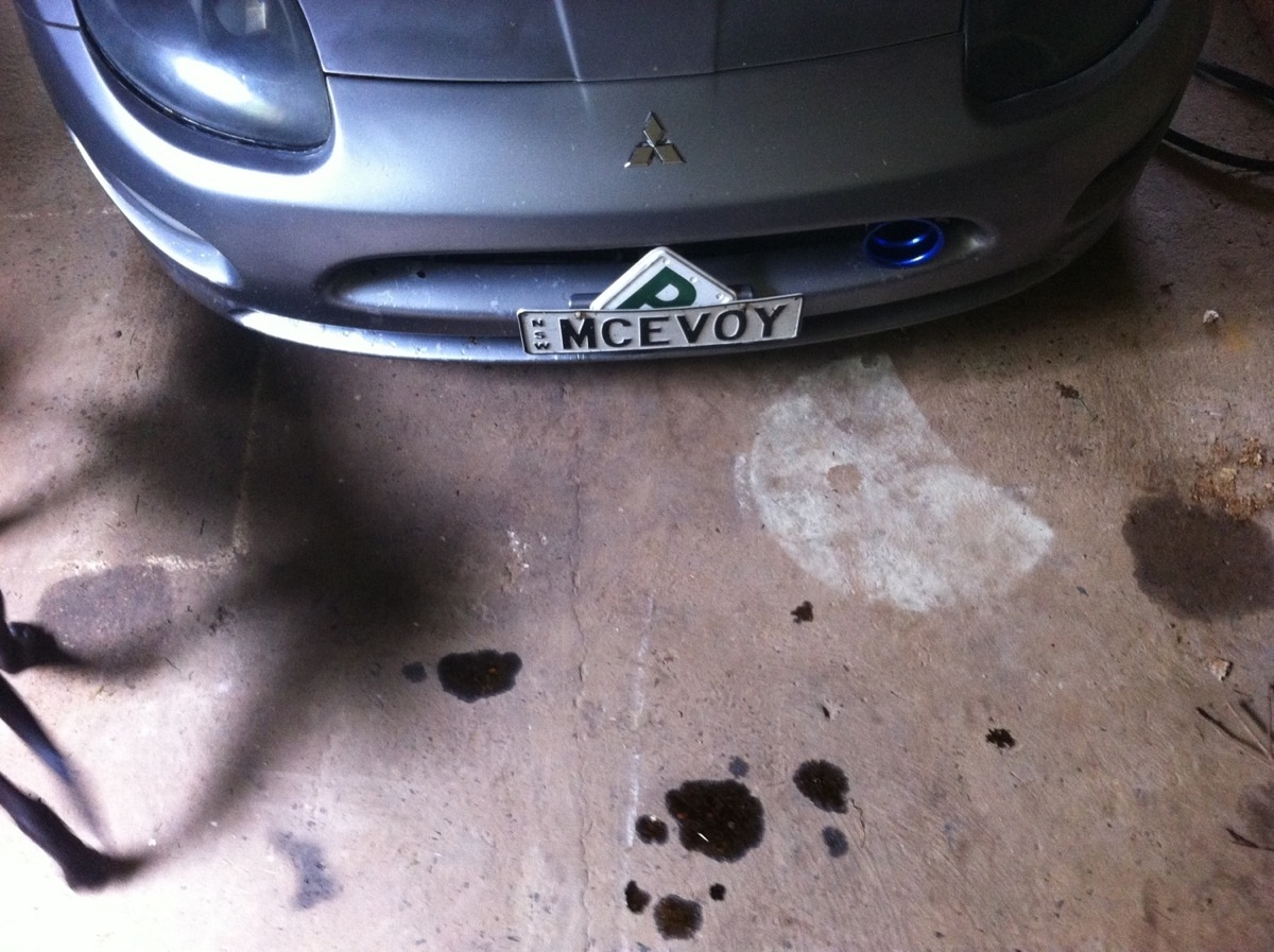

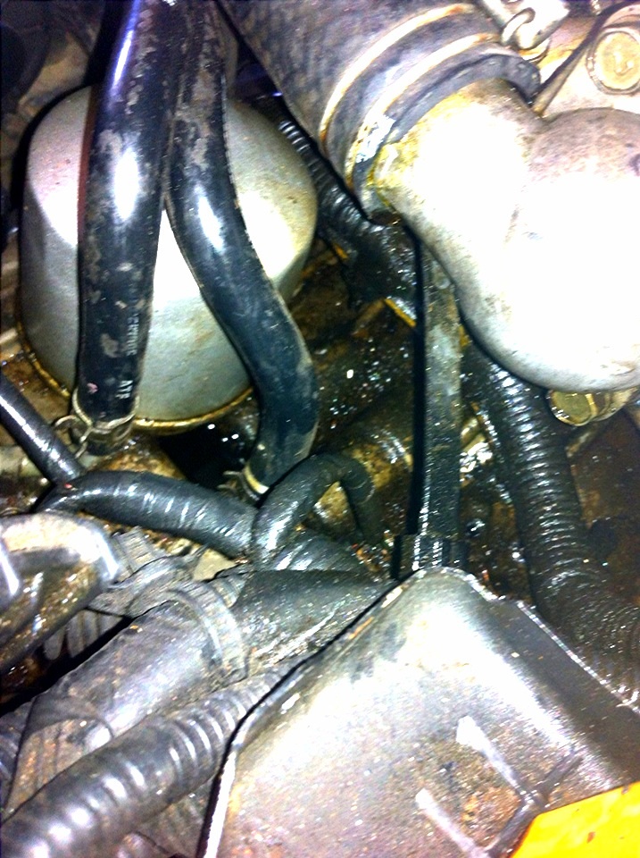

hey guys, past few weeks ive noticed lots oil leaking.
its allways had abit under and around the engine bay, but never drips till 2weeks ago.
i did the filter and oil change a few days ago and it has actually increased the amount of oil leaking.
the question is where from? it seems to be every where, under the sump and filter area,
but also theres a lot ontop and under the transmission area. (really doesnt seem like like tranny oil, as mine is very red and clean still.
have taken a few photos, and one of exactly where it dripped after parking the car for 2hours(both sides)

You need to degrease the engine bay and check it after the next time you drive it. It will always cone from the highest spot its showing. At a guess Im gonna say rocker cover gasket. Not an uncommon problem. Not an expensive one either you can do it yourself.

Might have something to do with there being more oil there for it to leak when you filled it from the oil changedestinationtoby wrote:i did the filter and oil change a few days ago and it has actually increased the amount of oil leaking.
And agreed with Taz, degrease and then check the rocker cover gasket, simple fixTaz wrote:You need to degrease the engine bay and check it after the next time you drive it. It will always cone from the highest spot its showing. At a guess Im gonna say rocker cover gasket. Not an uncommon problem. Not an expensive one either you can do it yourself.

Are you sure thats oil. Its got a green tinge. Looks like it could be water with coolant in it possibly leaking from top radiator hose/thermo housing. If there was caked on oil/grease on tranny already, you might be mistaking it for oil. Check your water levels to be sure. Take the radiator cap off when the car is cold and then turn engine on and make sure no bubbles coming up.
Re: Oil leaks
pretty sure its oil,
so where abouts is this gasket? i just need an idea of where to look/degrease and look agin.

Your front gasket is under the rocker cover on the front obviously. The rear gasket is under the rocker cover on the rear which is inconveniently placed underneath the intake manifold. Not a big jobs just requires taking it all apart, replacing gasket, checking and replacing everything.

think its just the gasket but its dripping more because i cleaned it all up and new oil.
