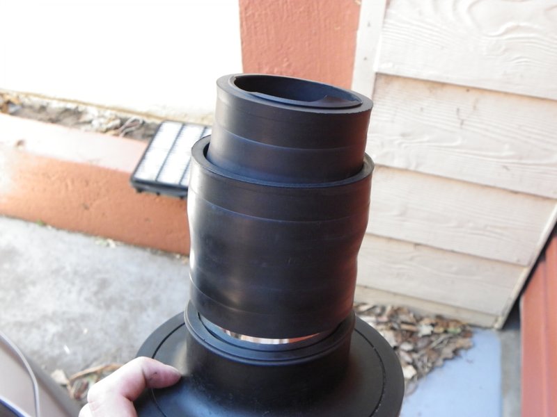

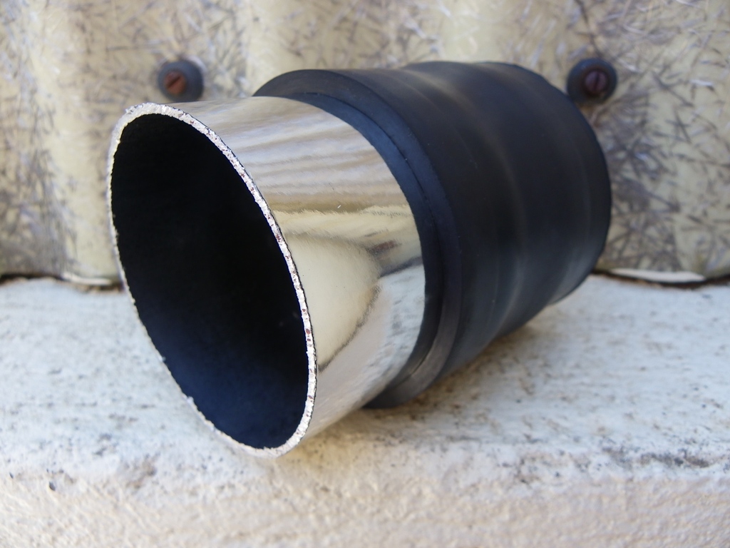

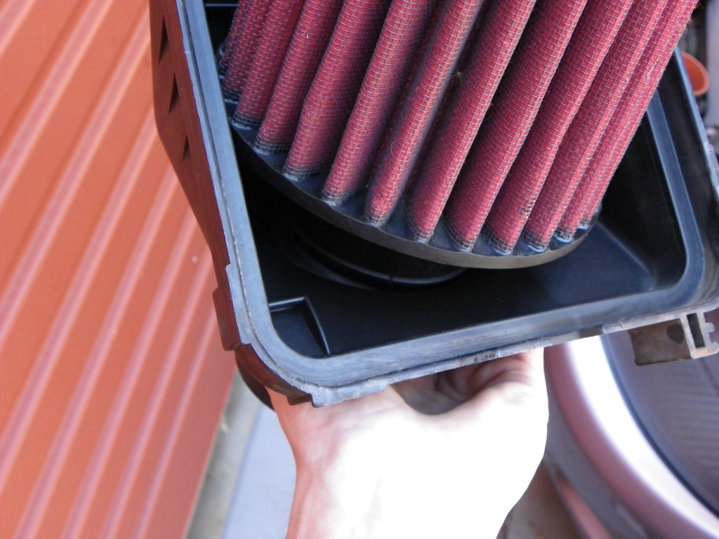

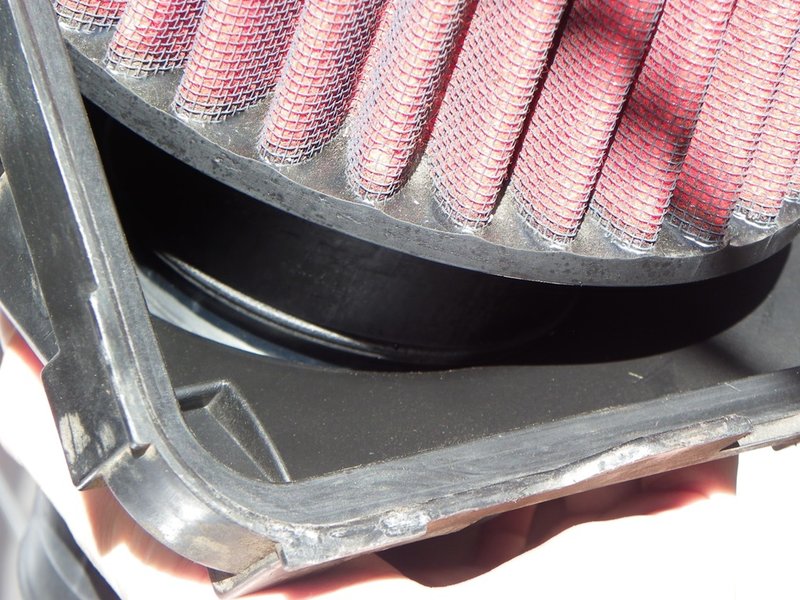

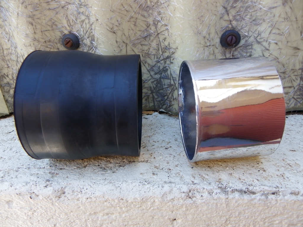

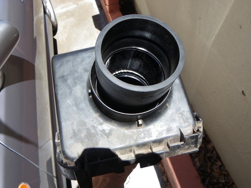

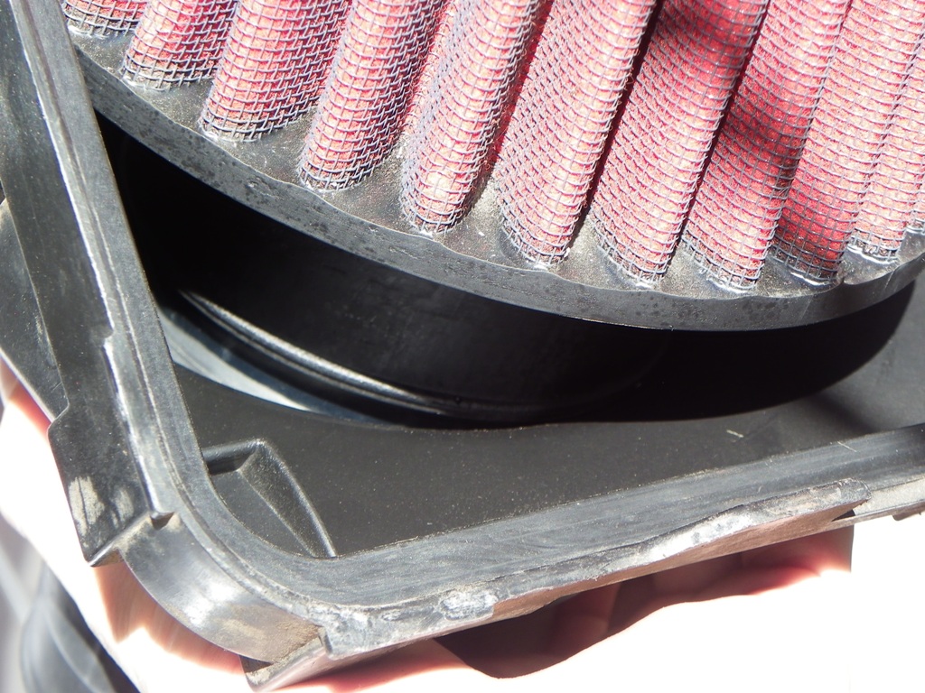

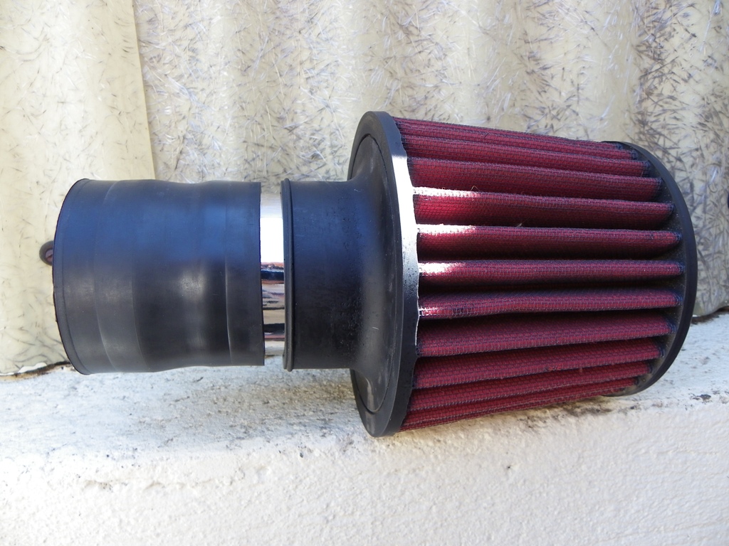

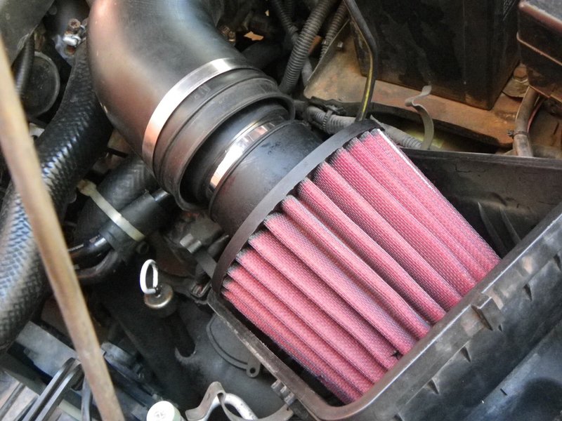

So the first few are the bits immediately from the pod into the pipes. the 5th and 6th picture you can see part of the gap between the end of the pod and the inside of the airbox. second last is sort of how it sits, but I can fit it with the cover, just an illustration. last pic is another rubber bit that I can add onto the end to enlarge the other piece so it fits even more tightly. It feels tight enough when I put it in without the airbox inhibiting it, but I can't account for how tight it is once it's all together.

If you can clamp the intake pipe to the pod filter pipe then it should be good. But whatever you do it has to be a air tight seal.

Looking at the photos I can see that the pipe from the pod filter sticks out of the air box a fair bit, so if you can use a hose clamp to tighten the stock intake pipe onto the pod filter pipe. You need to make sure no air can get into the engine from anywhere but the pod filter.
If the rubber pipe on the pod filter is too soft you may need to get a longer stainless steel pipe.

Ohhh, I get what you mean now. So, along the length of the pipe, just add another clamp. I'll see if I have one long enough.Vectose wrote:Looking at the photos I can see that the pipe from the pod filter sticks out of the air box a fair bit, so if you can use a hose clamp to tighten the stock intake pipe onto the pod filter pipe. You need to make sure no air can get into the engine from anywhere but the pod filter.

I wouldn't recommend trying to clamp that gap, its too big and the stock pipes tend to not clamp well, it will probably have a bit of loose material (that wont clamp down clean youll still have a gap somewhere on it) from trying to reduce the end size. Had the same problem for my HKS pod before i got a reducer. Your cheapest, best way to go is get something like electrical/gaffa tape, and wrap it around the end of the pod pipe where you would clamp down the intake pipe to it to fill the gap, then clamp it down. The tap should fill the gap nicely once its all clamped down. Another option is to get a reducer made up (just a short metal pipe that reduces the size by the ~10mm you need) shouldnt be more than 20-40 bucks at the local metal shop. (they might even have a bit lying round)
