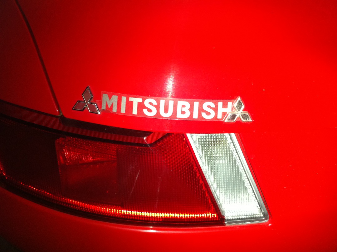

some bright spark before me has stuck an additional mitsubishi badge over the writing. No idea why, but now i need suggestions on how to get it off without taking off the paint. Not sure if its mostly over the "I" on the sticker so its not a massive deal or what depending on how much glue was used. But looks like I need a new sticker too once thats off.
Any ideas?

Warm it up with a heat gun or hair dryer and then carefully pull it off or pry it off. To pry it off use a small flat screw driver, use a rag as a pivot point and lever it up.

ah didnt think about that! ill give it a go

Yeah, heat gun is the key

PHIL069 wrote:use a small flat screw driver and lever it up.
heat it up and use a piece of fishing line

The badge on the left isn't supposed to be there either
