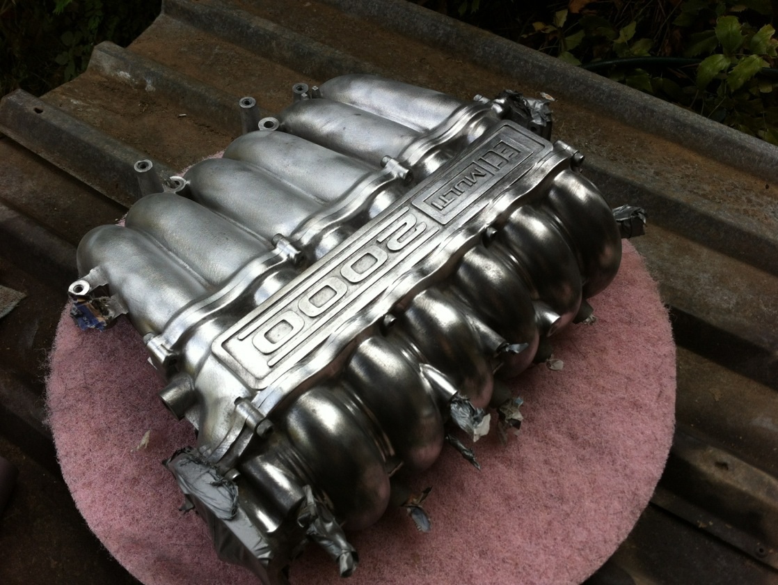

Get it sandblasted first. Cleans & roughs up the surface at the same time, giving the paint a good texture to bond to.

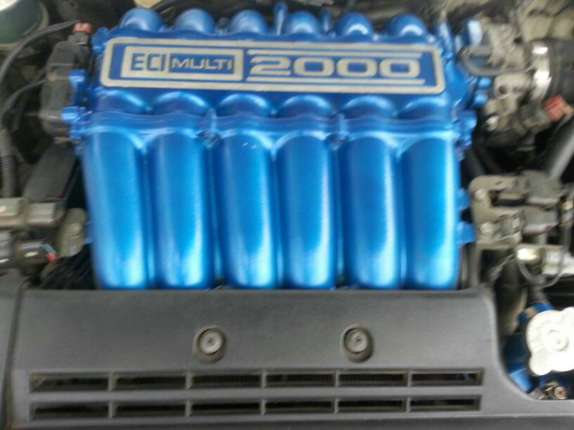

i even got paint made up at autobarn that wasn't high temp n painted where it says ECI MULTI 2000 and it hasn't flaked off or anything though the guy assured me it would be ok! but stress less buddy!

ive been painting my rocker covers inlet manifolds for years with normal paint cause there is more colors available and ive never had a problem

I've not had a problem yet with mine either and mine needed a base coat due to the type of paint

is that blue anodized paint if so ive used that paint the the colors are awesomeZFL45H1 wrote:I've not had a problem yet with mine either and mine needed a base coat due to the type of paint

Not sure can't remember all I know is it came out of a can hahaha
Re: Painting Throttle body
wow zflash thats a great result! mine came out a lot darker but still nice.

Thank mate I sand blastard mine and painted that's it
