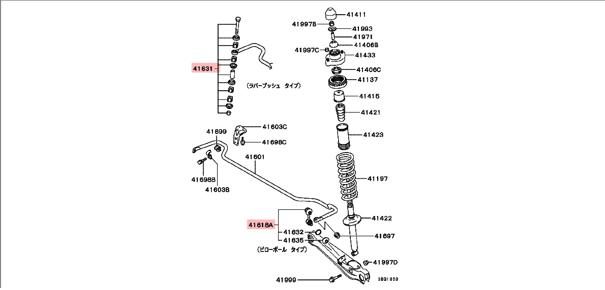

So on the quest to get the car ready by april amongst the list is to replace the links with new ones with poly bushes.
I know the GPR is different, but with search results coming up with screw all im not sure where or what will fit.
First question - will these bushes fit a GPR link? are the bushes inside them the same?

The droplinks for the Version R are not bushes, they are ball joints. Rear are the same as the GPX and fronts are the same as an EVO 3 I believe. I bought mine from Camskill.

Yea, it would be useless. GPX also uses ball joints. Only ones that use the bushes are GR, GX and GS.

Haha, the mounting point on the swaybar for GPX/GPR is vertical, for GR, GX and GS it's horizontal, as shown in the following diagram.
