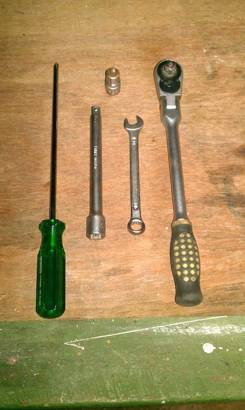

OK - so this should take you about 20min and you will need the following tools (shown in fig.1)
- Ratchet with 10mm socket (highly desirable, preferrably a flexible head 1/4 drive)
- Extension bar (desirable, preferrably 15mm)
- Phillips head screwdriver
- 10mm Spanner if you dont have a ratchet

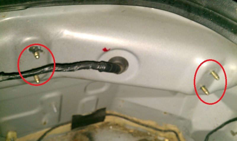

Now, take out the tail lights - undo the 4 bolts (found below), then unplug them. They come out very easily so don't force them, just push the button down and remove the plug.
Now push on the thread left behind from undoing the 4 bolts and the tail light should push out into your hand. Gently grab the wire from the outside of the tail light where it goes through the boot, and gently pull on the suction cup thing holding it to the boot, it should pull out relatively easy and thread the plug through the hole thats left and you should have a full tail light in your hand to put aside.

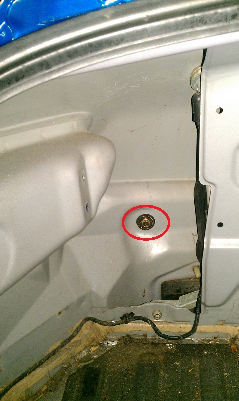

Next, undo the 3 screws found below. When they are all out, gently put your hand behind the panel and gently 'pop' the little black plug left behind into your hand - they should pop out very easily, so do not put any stress on the bar.

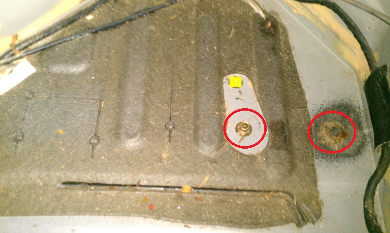

Now, undo the 2 screws either side of the boot on the side wall (below) and the two screws that are under both tail lights by themselves (2nd below) - shown in red.
Lastly, undo the 4 bolts either side of the wheel well (below) to unbolt the rear rheo bar.

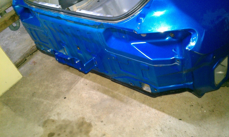

If you have done all of the above steps, then the rear bar should slide out the back.
Your car will look like the pic below but a little more dirty :cheeky: as i cleaned mine up before taking the pic :oops:

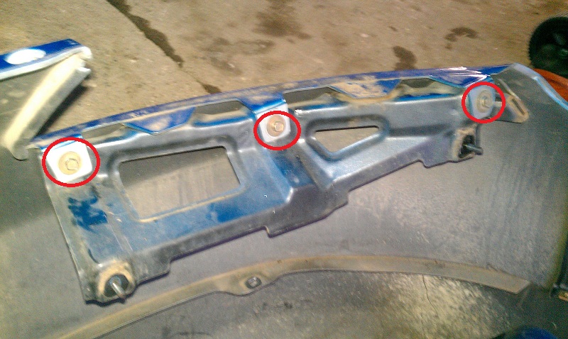

Depending on why you are taking it off - you will need to remove the rheo and 2 support bars from the rear bar and switch them over to the new bar.
There are 6 bolts holding in the support bars (below) you will need to take out, and 4 bolts holding in the rheo to the bar found underneath.
