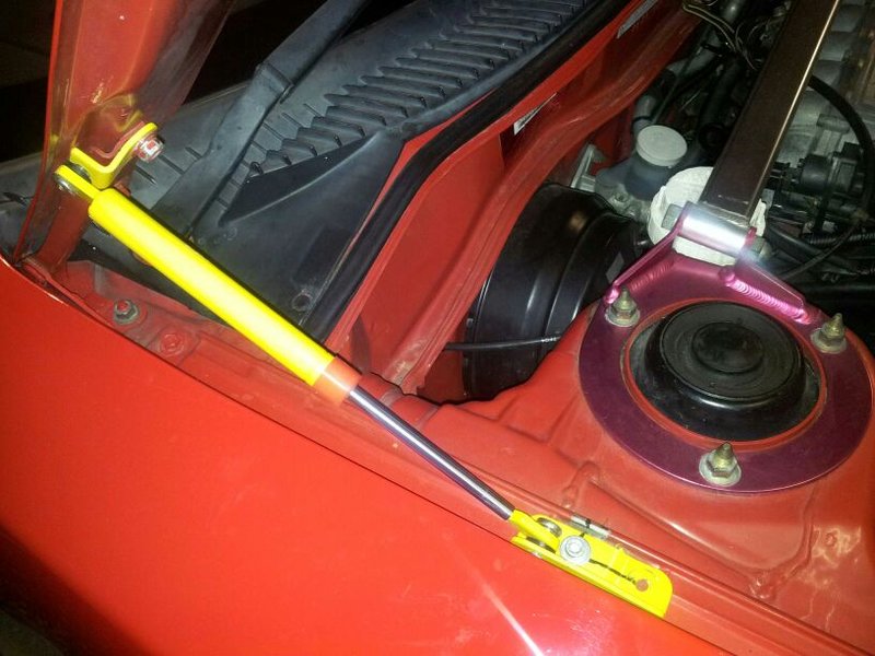

I've got some, used universal ones. Only minor mods to fit.

would you be able to post up a picture of yours mounted ben?? would be greatly appreciated.
Posts: 23676
Re: Gas struts to suit FTO bonnet??
viewtopic.php?f=22&t=15644&start=1080
I did paint them red in the end ;)

Vectose has them. They're great, stops the bonnet from warping :D
Rob where are you!
I'm here. :lol:

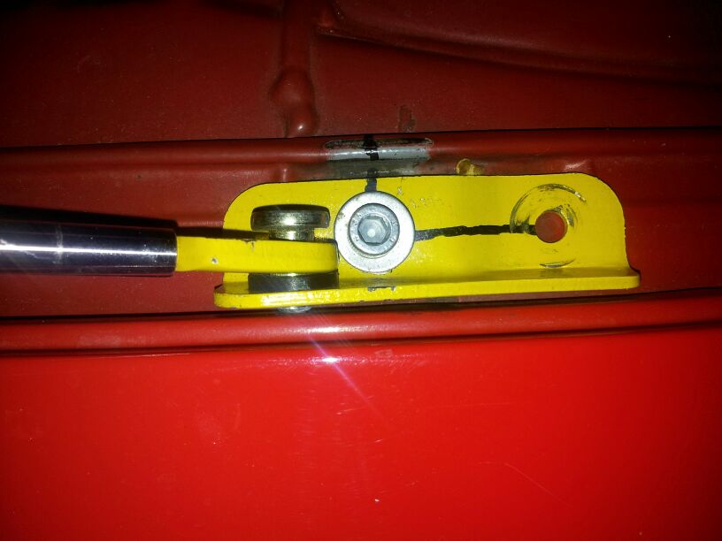

Yes, I have them. Only modification needed to fit them is a hole drilled into the bottom bracket. If you use the hole that's already on them the bonnet will only close half way.
