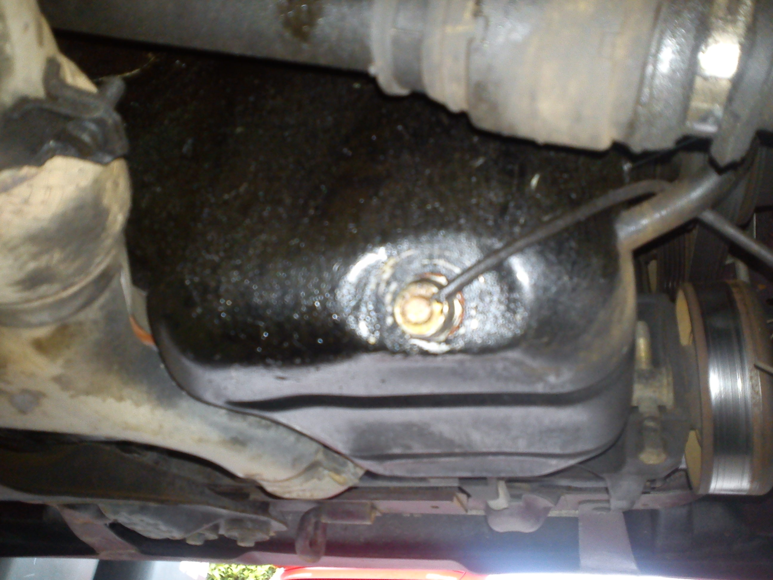

If you recall, the FTO at least, had an oil temp gauge as an optional extra. It tooks its reading from a special type of sump plug (I know a few guys are asked for pics from the wreck for sale thread, as its got one in it.)

Yep too easy. I was doing a similar thing, except using the sump sender for temp.clint111 wrote:The thread, Ben, was about where to fit another pressure sensor, or temp sensor.
