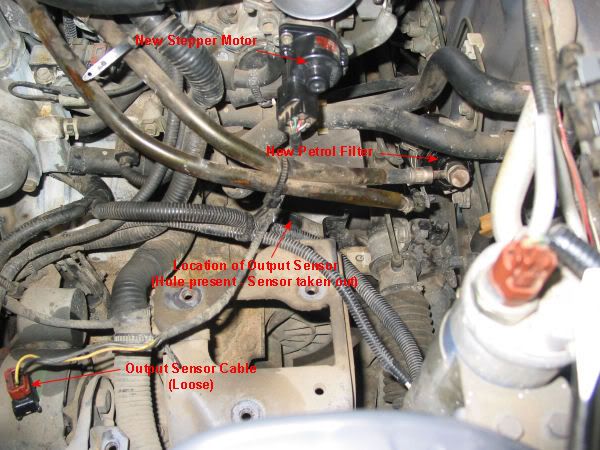

Hi all,
I have to pump the accelerator for my FTO to start. Then when I am driving if I ever put the car in neutral (eg. stopping at lights) the revs go down and the car dies (occasionally it'll juuuust save itself and then hang around 4-500 rpm).
I tried disconnecting the battery to reset the computer, which fixed the problem for a couple of hours, but then it just came back.
After lots of searching these forums I presume that I need clean the throttle body/idle speed controller/stepper motor (not sure of the difference between these things, everyone seems to have a different opinion on them), and then if that fails, buy a new one (again, not sure which of the three).
A lot of the forums just say "Clean the throttle body". I'm not very experienced at this sort of thing. Could someone please post a picture of exactly where/what these things are and also how do I clean them??
Thanks so much.
Pete

heres a site i just came accross it should help you out dosent tell you how but dose have a pic showing where the stepper motor is and a few other diy's that may help u in the future
http://mitsi-fto.blogspot.com/
all the diy's seam to have been taken from this site
