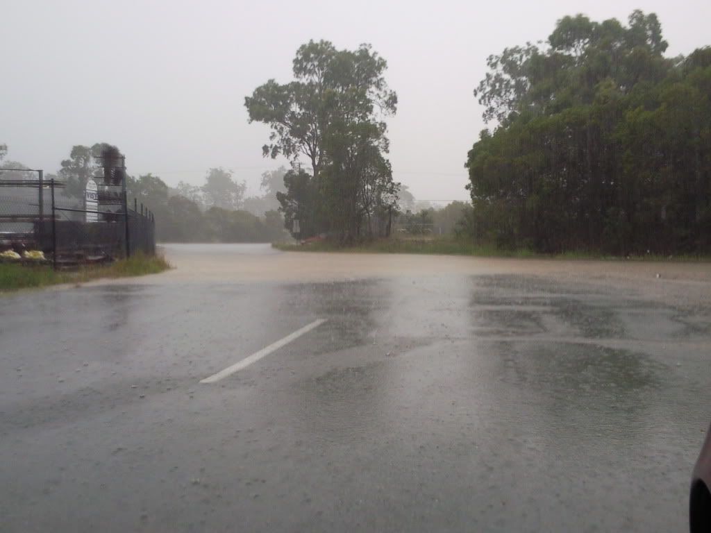

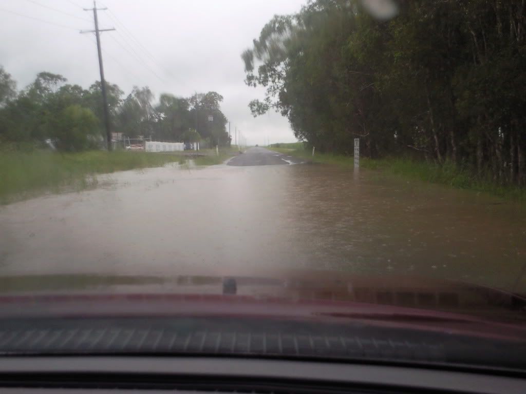

Your better buying the USA kit over the ebay link, however I still think the UAS is over priced, for what you get.....IMO.
Oh and dont go through puddles like this

lol yeah it was and that was only after 3 hrs of rain.
QLD Roads FTW
When i drove through it it was up to my doorsill, lucky i didnt take the fto or it would been up to my window lol
QLD Roads FTW

You can still go through puddles like that without any problems. I have a feed under my bumper at the moment and went through a deeper one than that last Sunday. The feed would have been under water. The trick is to not go through it fast (which is a really bad idea anyway). As long as the spped isnt high, the water wont go vertically up the pipe into the air box;
