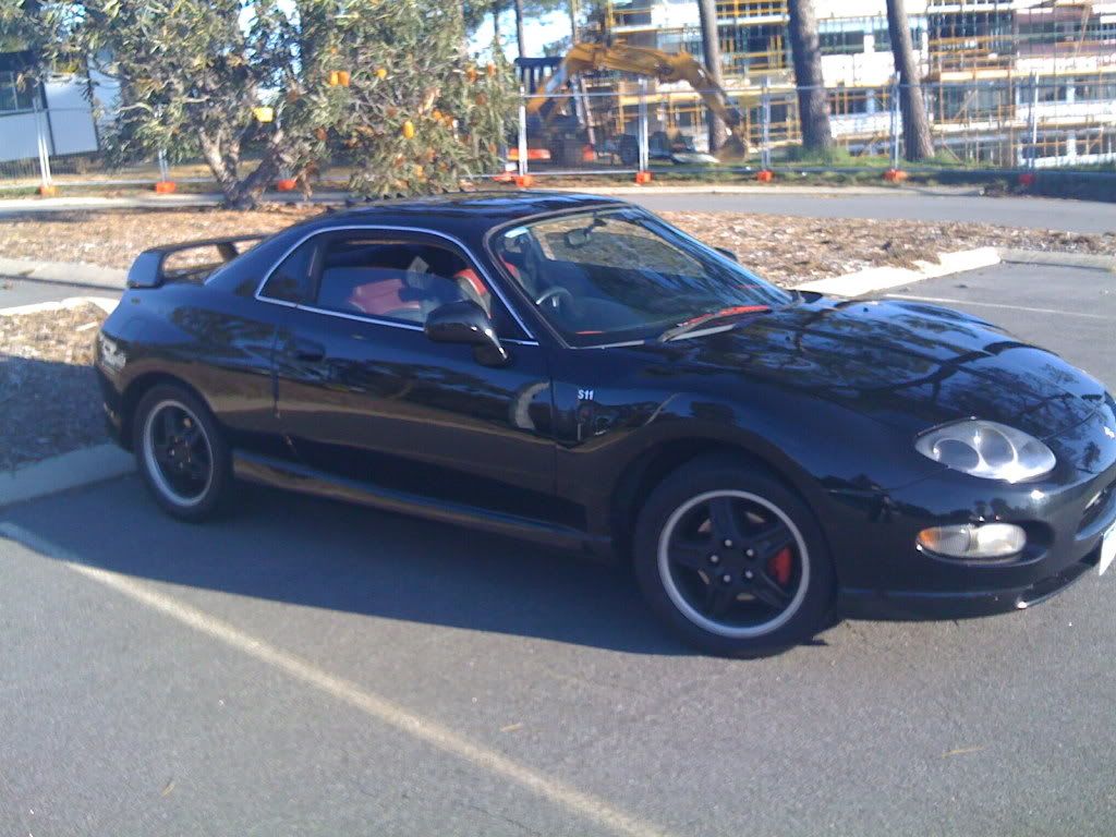

hey mate, i have changed my weather strips. i had the same problem, and i bought automotive weatherproof glue, its used for trims and stuff. and yeah u can just apply a bit of that and it should do the trick. Usually, those weatherstrips come with small black clips which attach to the frame of the window. if u dont have em or missing em, then glue is the way to go. i personally got tired of those weatherstrips, took em off and used chrome mouldings on em instead. you could cover it up with something else i guess. the original leftover glue residue was removed using a adhesive remover.
ended up lookin a bit like this.
