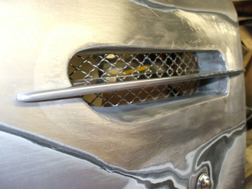

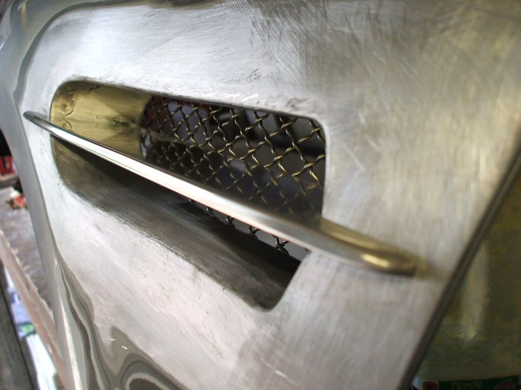

I ve made these db9 aston vents were the idecators used to be . They have been lead welded and filled. Last of all polished stainless steel bar and stainless mesh.

Thats a damb nice job. Are the vents hand made or off something else

    They are hand made , ive just made an aston style front bumper, db7 bumper and two fto s cut and made deeper, and ive even got the metal slated grill in place 8)

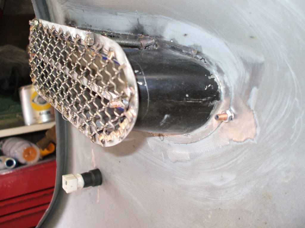

    mike .. Could you explain how you did this?
    How did you get the recessed part where the SS Mesh is mounted? Did you have to weld something in there? or is it bolted in? what did you use for the recessed bit? looks almost like plastic from the inside .. almost like the pod for the foglights so I'm a bit confused about it.

    Hi guys, i made a template the shape of the vent, scaled it down to look right with the size of the fto wing , then made a template for the inner trim. a lot of working out, welded in,and lead filled after. Ive just converted a db9 rear stainlees exhaust box to fit
