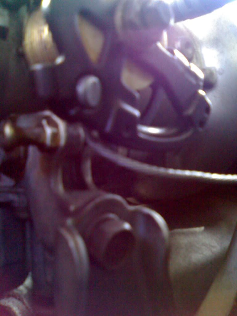

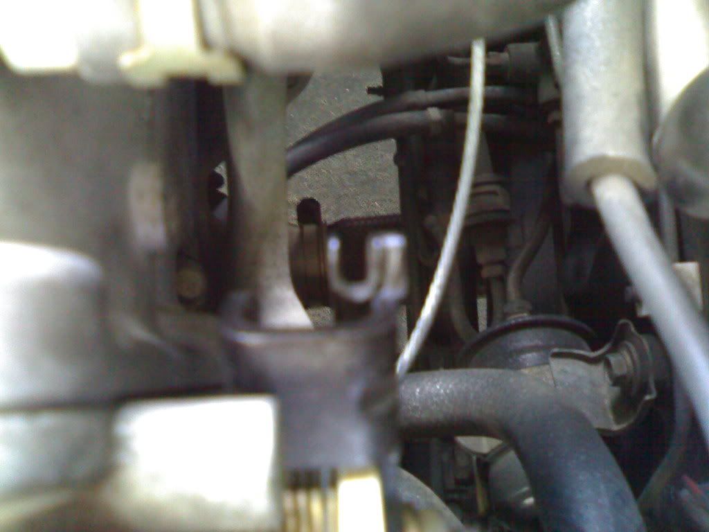

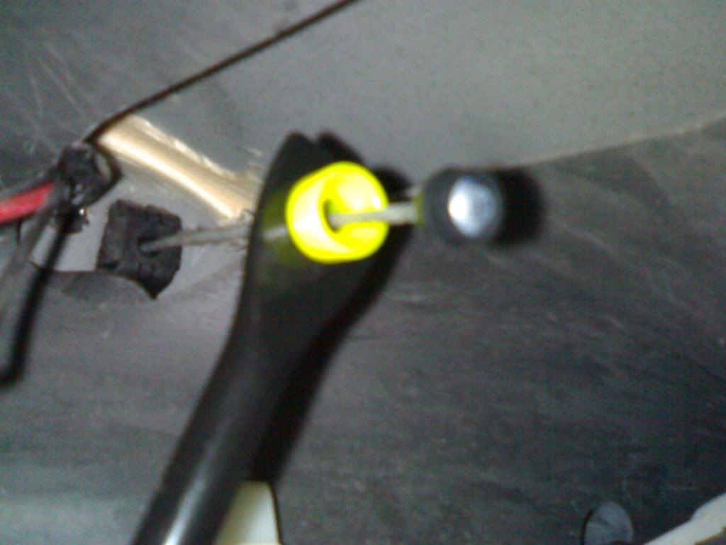

    No such luck, but took some pics to show what it looks like.
    Above the Accelerator Pedal
    Throttle body from the right hand side
    Throttle body from birds eye view ( with the throttle pushed down to show the groove)

    so if you disconnected the cable at the throttle body side and then pulled on the cable inside the car, does it move the cable under the bonnet? If it doesnt then id say its definilty a breakage. However i still dont see why the throttle would of stayed what, that makes me believe it must be something else
