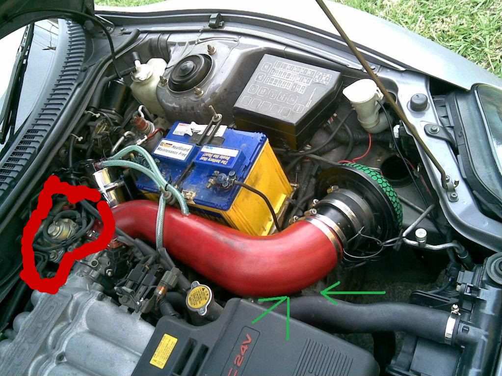

im doing my rocker cover today guys and iv havign a bit of trouble with the throttle body....iv removed the intake pipe and the mivec cover and the four bolts on the side of the throttle body but the one ahe back how the f**k do you get to it? the thing iv circled is in the way
the thing you circled seems to be an aftermarket item. Mine doesn't have that in there. It looks like an aftermarket fuel pressure regulator. What's the hoses on it attached to?
You will have to remove the cooling lines thou if you want to remove the TB completely. They attach to the underside of the unit. Be prepared to block the hoses with screw drivers. You'll get some coolant leak.
