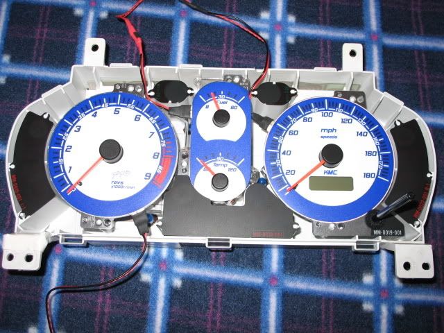

        If anyone was intersted in a pic of the wires run out of the console here it is:

          No worriers, please do. So it's pretty much the same thing you did? The only thing I had to play with a bit is the fuel temp wiring, to keep the plug straight I just pushed the wires down with a small screwdriver between the left indicator light and the tacho, seems ok. From what I can see there is no way to get away from the small bend in the speedo plug due to it's proximity to the fuel/temp dial.

          Yep, I did the same. Cant avoid a small bend there.
