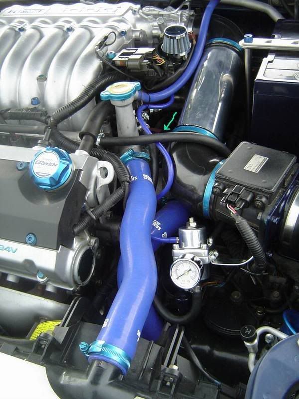

If all of the above are ok, I'd be checking the ECU engine temp sender unit. The cooling system uses 2 sensors. One is a single wire sensor near the thermostat that tells the gauge what temp the water is, the other is a 2 wire unit that tells the ECU what to do at what temp. Everything from adjusting the air/fuel mixture to when to turn the thermo fans on. It would be the one too look at.
Pic of where its located:
Red arrow is ECU sender unit
