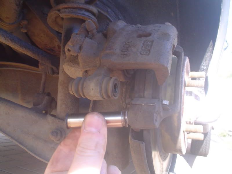

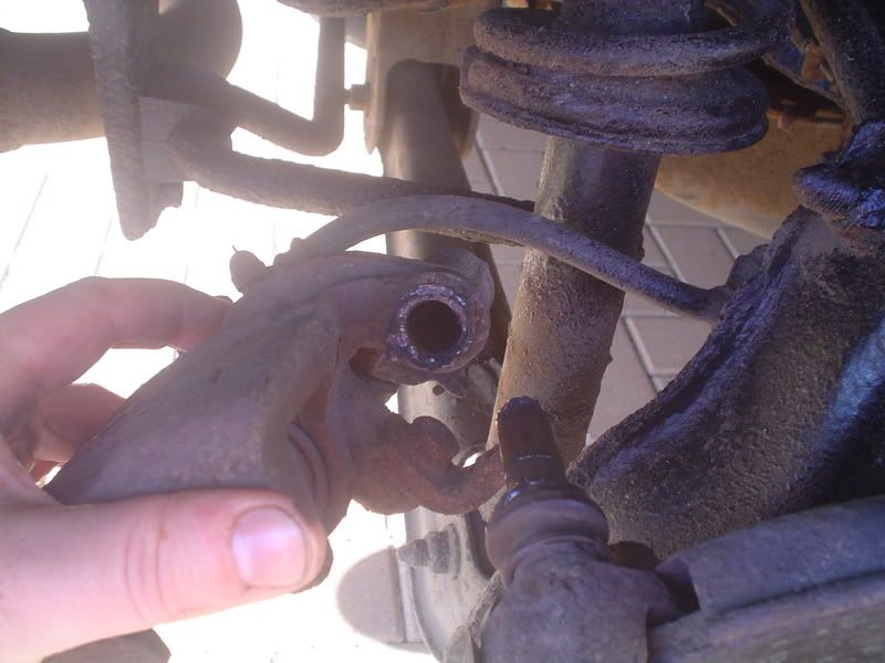

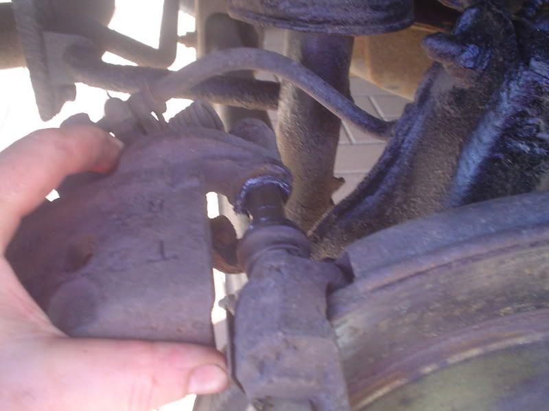

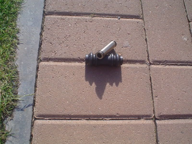

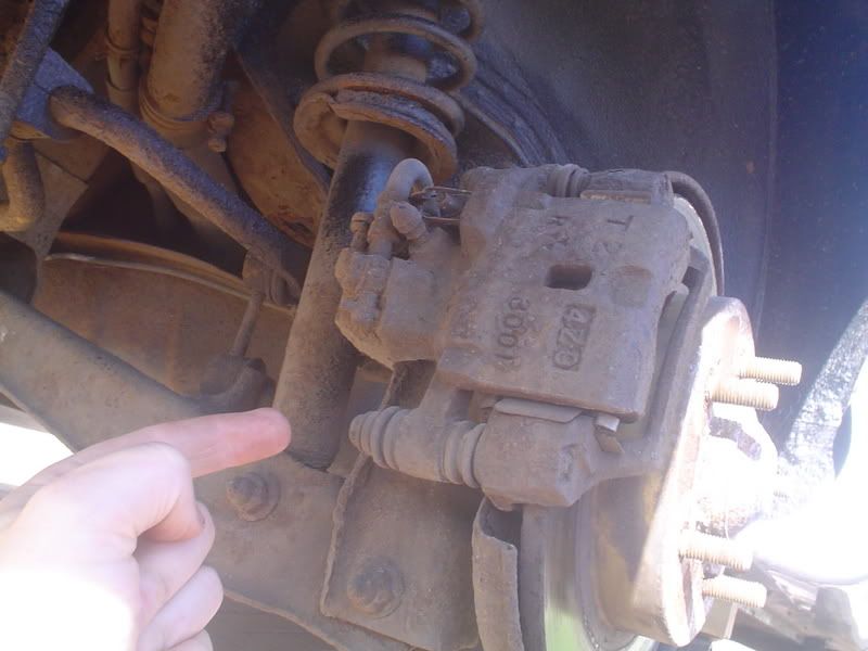

If its seized Max then the seized pads would be meatier as they're not being used.
You probably have sticky sliders, which sound much less sexy than it actually is and doesn't even involve bleeding any fluids.
Get inside the car and remove the centre console so you can loosen of the handbrake as you will need to remove the cable to get the calipers off.
Pull of the rear wheels and undo the caliper as if you are going to change the pads, this bolt first.
in fact thats the only bolt you need to take off.
The boot goes through a slider pin which is sealed with a rubber boot. You can take the pin out of the boot and can actually remove the boot as well to give it a good clean and regrease it.
Once youve done that slip the top slider off, you dont need to undo any bolts, just slide it off and give it a good clean and a regrease
Once its all cleaned put it back together and you should have more effective brakes and a better handbrake to boot.
It only takes about 15 minutes a side.
