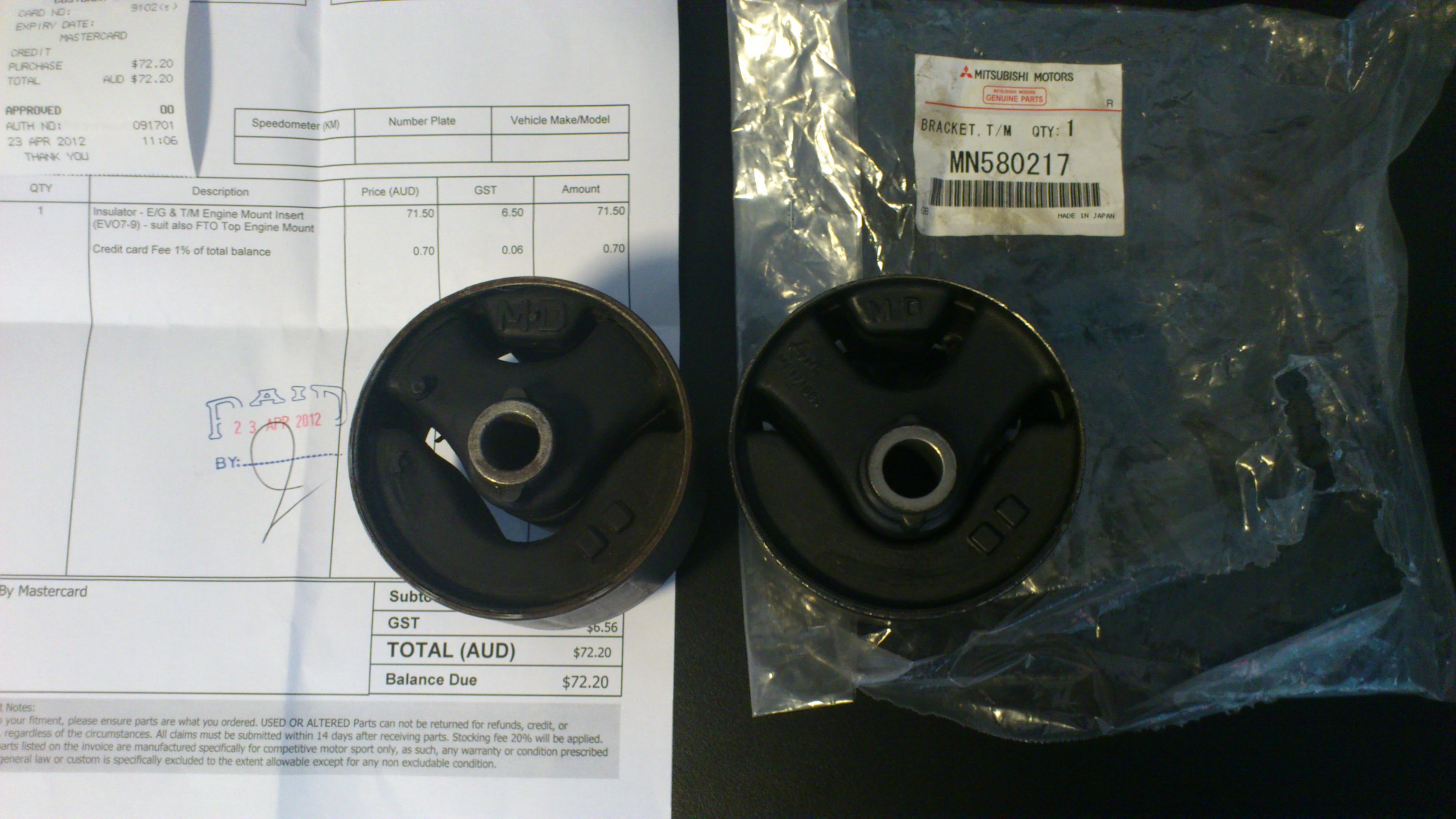

Ok, so I found a side mount that fits today :lol: Turns out its a Ralliart product, the same as an Evo 7-9 top mount. Made from HS90 hardness rubber, its significantly stiff than the old mount.
http://meek.com.au/index.php?act=viewProd&productId=520
Mitsubishi part number MN580217. Price was $71.50. Yes it will fit both the gearbox side mount as well.

Bennoz wrote:Ok, so I found a side mount that fits today :lol: Turns out its a Ralliart product, the same as an Evo 7-9 top mount. Made from HS90 hardness rubber, its significantly stiff than the old mount.
Sweet hard is what ya want!
Can you get them from any Mitsubishi dealer? I get trade!
Posts: 23676
Re: DIY: Changing lower engine mounts
Apparently so, just quote that part number!
