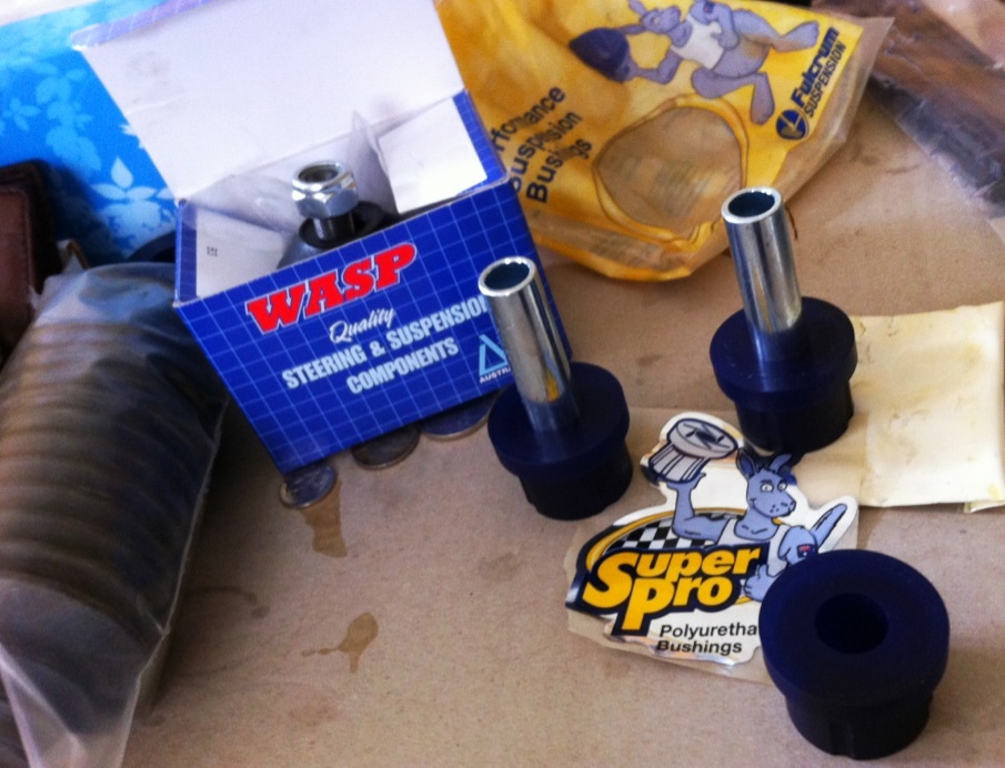

just got both parts from clevers tyres
bushes $43
balljoint $33
i sorta want to put them in now and cbf seeing a mechanic.
what sort of method is there when using a vice? i cant really picture it :)

Re: Trying to workout what this noise is
You sorta get half of it in the vice & push it in a bit, then flip it over & do a bit on the other side. Remove the rubber boot before you do it.

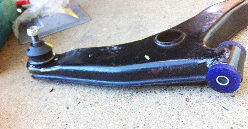

progress
ball joint and bushes are in :cheers:
im moving onto the tie rod ends. i will you tube how to.
but is there anything in particular i need to know.
from memory there was something about remembering how many turns it took to remove :scratch:
destinationtoby wrote:from memory there was something about remembering how many turns it took to remove :scratch:
Correct.
Ensure firstly that the shafts are the same length, otherwise it will not work out the same.
Posts: 23676
With the tie rod still in place, I wrap some electrical tape around the threads of the steering arm right up next to the lock nut next to the tie rod. That way, if the nut moves when you wind back on, you know when to stop.
Having said that, the tie rod may not be identical to the old one, so I'd be off to get a wheel alignment regardless. Especially since you've done the bushes as well.
The fuking bolt in the ball joint just keeps fuking spinning making it impossible to tighten.
ive tried clamping it and bashing it back in, is there a technique or is the solution just to bash it back up there harder.? (which is difficult because the new one has grease nipple things) fuking been stuck on this for 2hours
Use the weight of the car. Put a jack under the bastard when you have the inside bolts on.

    dstocks wrote:Use the weight of the car. Put a jack under the bastard when you have the inside bolts on.
    :cheers: genius. Thankyou!

    Post by payaya »
    I always thought you just shove an allen key in the top of the ball joint to stop it from spinning while tightening but obviously it's not there for that??? 8O
    Your thinking of droplinks.
