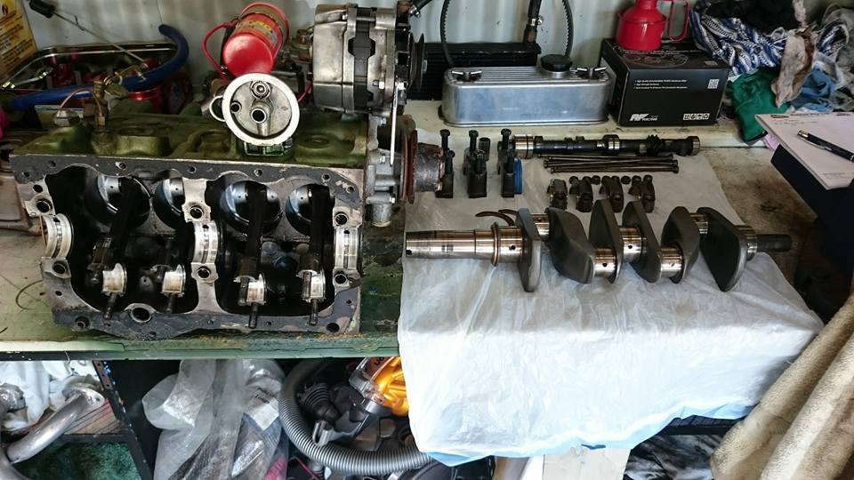

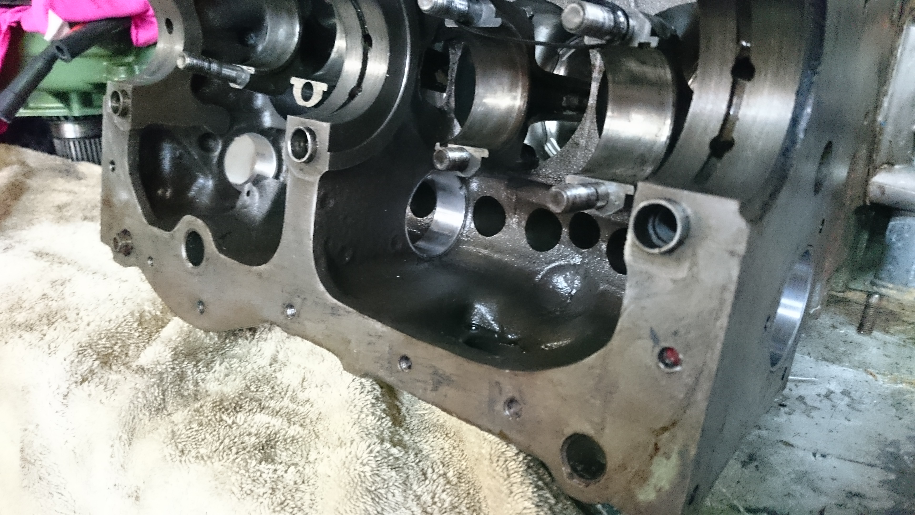

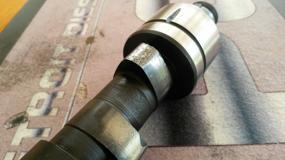

    So after rebuilding the gearbox, I did a quick check of the motor before I was going to put it all back together... it needed rebuilding as well :lol:
    A couple of dodgy cam followers destroyed the cam. Crank is ok, just needs new big end & main bearings, also thrust washers. Don't have to pull pistons, the bores are ok.
    Got all my parts bar the new cam which should arrive tomorrow. New cam bearings went in this morning.

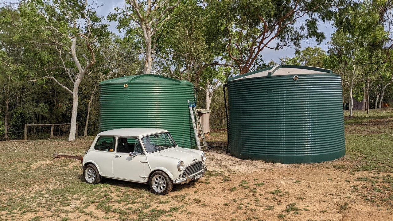

    She a farm mini now :D
