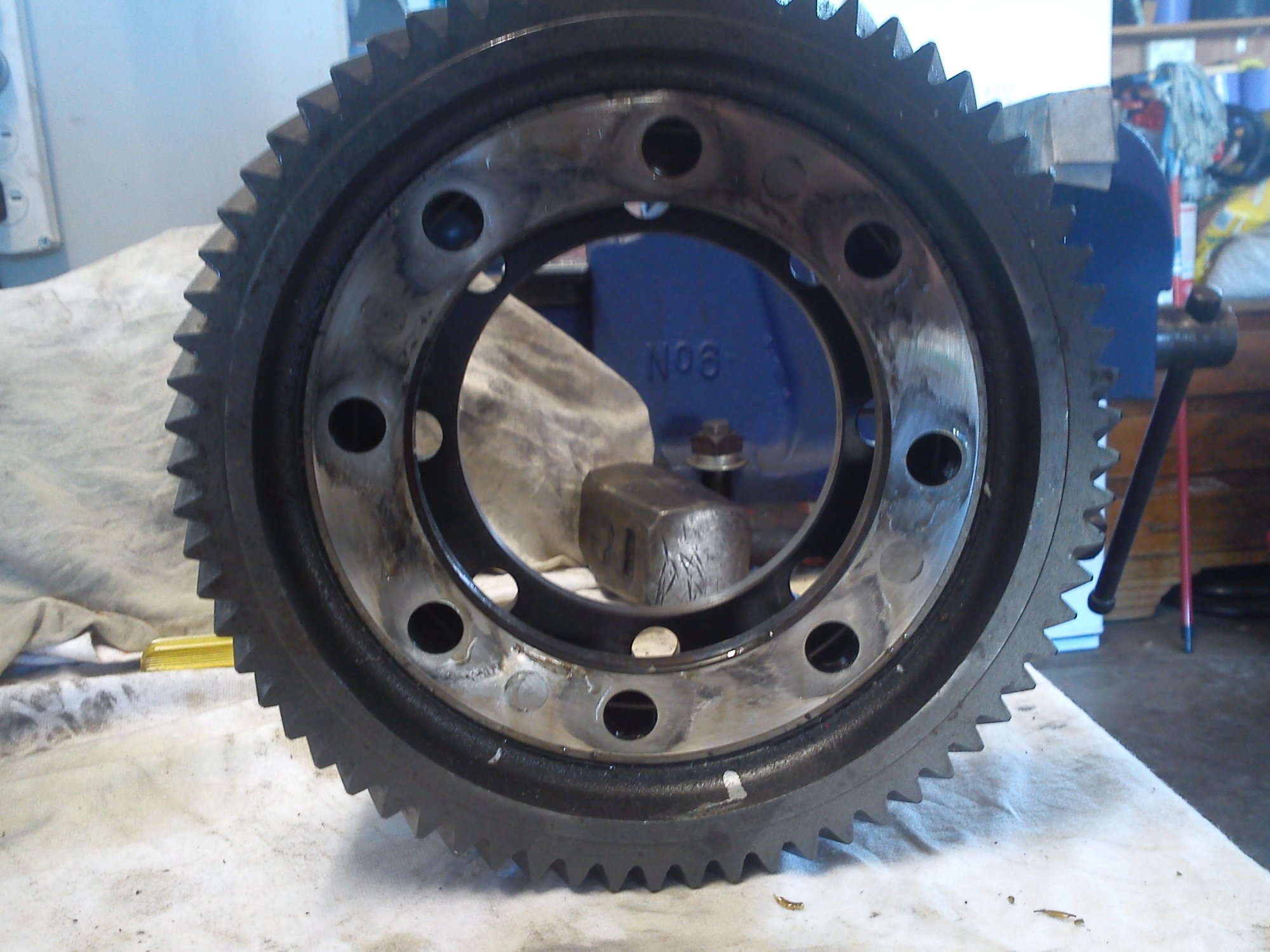

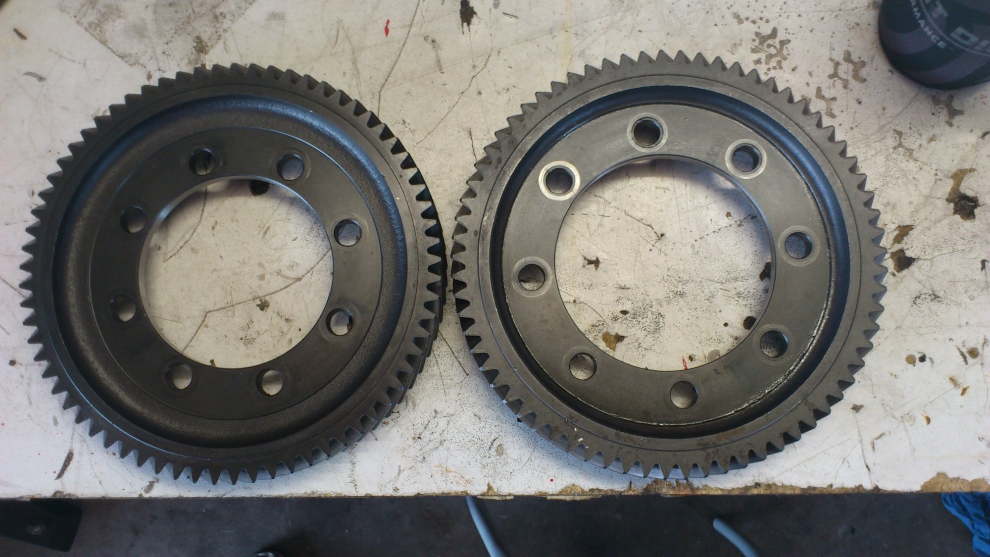

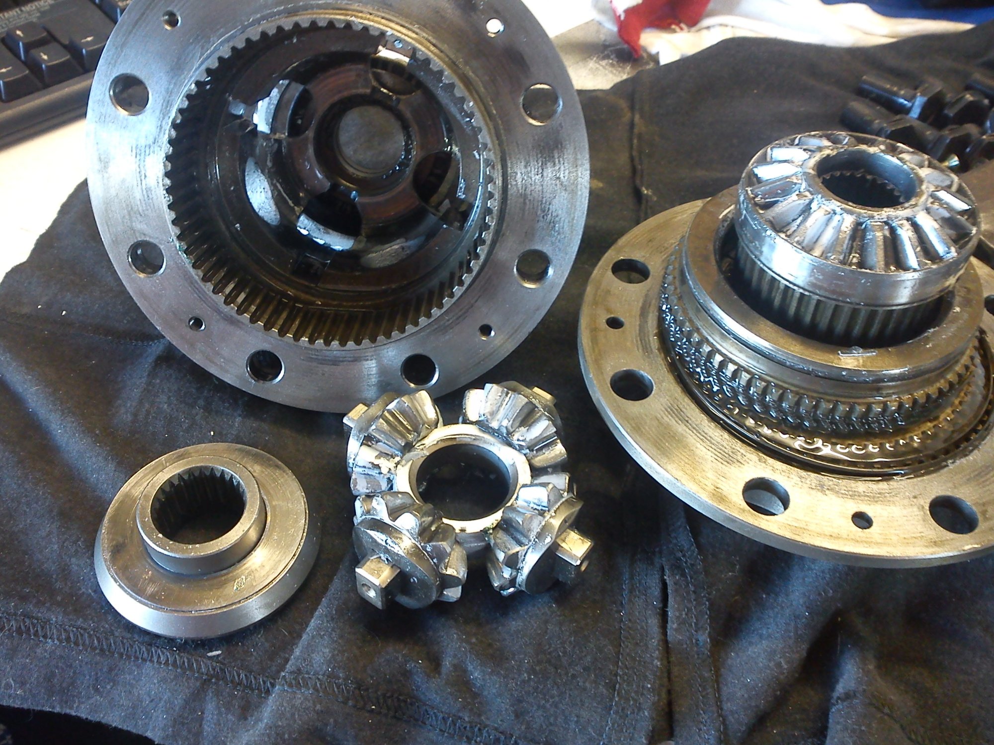

Viscous from Version r slushbox (right) vs Manual (left)

Verison R are helical not viscous, yes the final drive gear is different, even for the manual viscous and helical they use different final drive gears.

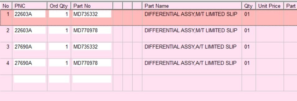

Ok, so if that ASA extract is to be believed, you can swap like for like (PFL with PFL, FL with FL) but go back to the original question. Can a 4 speed auto PFL viscous, fit an auto FL 5 speed with open diff.
What's the part number for a 5spd auto final drive gear with open diff? Is it the same as a 5spd auto helical final drive gear? If so, will that final drive bolt to the 4 speed viscous? The answer is most likely going to be no.

Crown gears from Autos 4 speed and 5 speed all say part spec N=62, Manuals that I've found so far say N=69 - wonder if this is number of teeth?
MD735332 - LSD from 4 speed auto
MD757593 - crown gear part spec N=62
MD757594 - crown gear part spec N=62 - from a GPX auto no lsd.
MD757190 - crown gear part spec N=63 - from a GR auto, didn't expect them to be different.
MD748012 - crown gear part spec N=69 - from a GPX manual 1995
MD770978 - LSD from 5 speed auto
MD760946 - crown gear part spec N=62
(MD760946 - GPVR Auto 1997 (DE3A-0201510) HYFH3, part spec N=62)
So it seems that 1997 auto diffs are interchangeable between GPX and GPVR, my crown gear will fit on a 5 speed LSD (I think) but maybe not on the 4 speed LSD since it's a different part number it could be different bolt pattern or something, or size.

Just counted teeth on those viscous crown gears in Bennoz pics and both 69 Teeth (these are diff crown gears right?)
Is the right one definitely out of an Auto as i'm only seeing 62 teeth on the Autos in ASA?
The crown gears for Autos that I've identified so far are 62 Teeth if Part Spec N=62 is correct, manuals seem to be 69.
