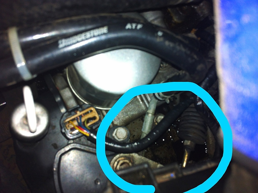

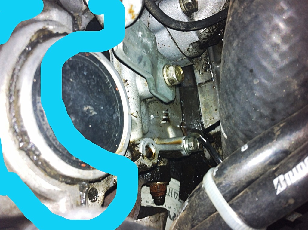

hey guys just wondering if this is an area the rc gasket will be going when i replace?
thinking that this is where it should be leaking the most as below this is the transmission box which has the pools of oil on it. have degreased and cleaned this area then drove a heap today, oil has appeared again on the transmission but really doesnt seem to be coming from here, maybe a little but not enough.
just trying to workout where else

Yeah mate thats it and it goes around the inside edge of the roker cover...

cheers manSahin wrote:Yeah mate thats it and it goes around the inside edge of the roker cover...
but do u think that from that first picture, that this could be leaking enough to cause this?
Re: Oil leaks
Well best bet is to replace it anyway, as it needs it, then rinse and repeat - if its still leaking you know theres something else at play, if not then you know you got it

NO! lol a rocker cover is not going to leak ALL the way down there. Its something else. Most likely on the gearbox. That would be pretty much oil absolutely PISSING out of the rocker covers to build up like that.
Looks like near the input and output sensors, could be leaking from there.
