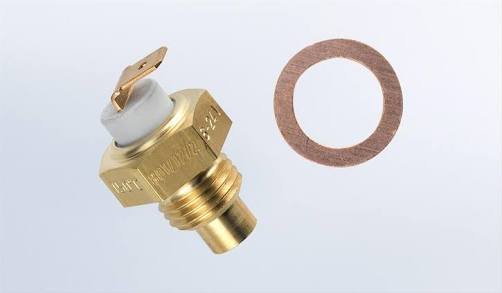

Vectose wrote: ↑Fri May 25, 2018 9:20 pmimages-52.jpg
Is this a sensor that you’ve found that’s compatible with the Mitsi gauge rob?
Posts: 3955
Re: Oil Pressure/Temp Guage - Sandwich plate?
Nah, that's for a VDO gauge.
