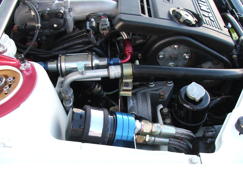

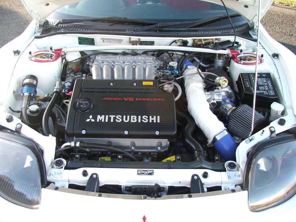

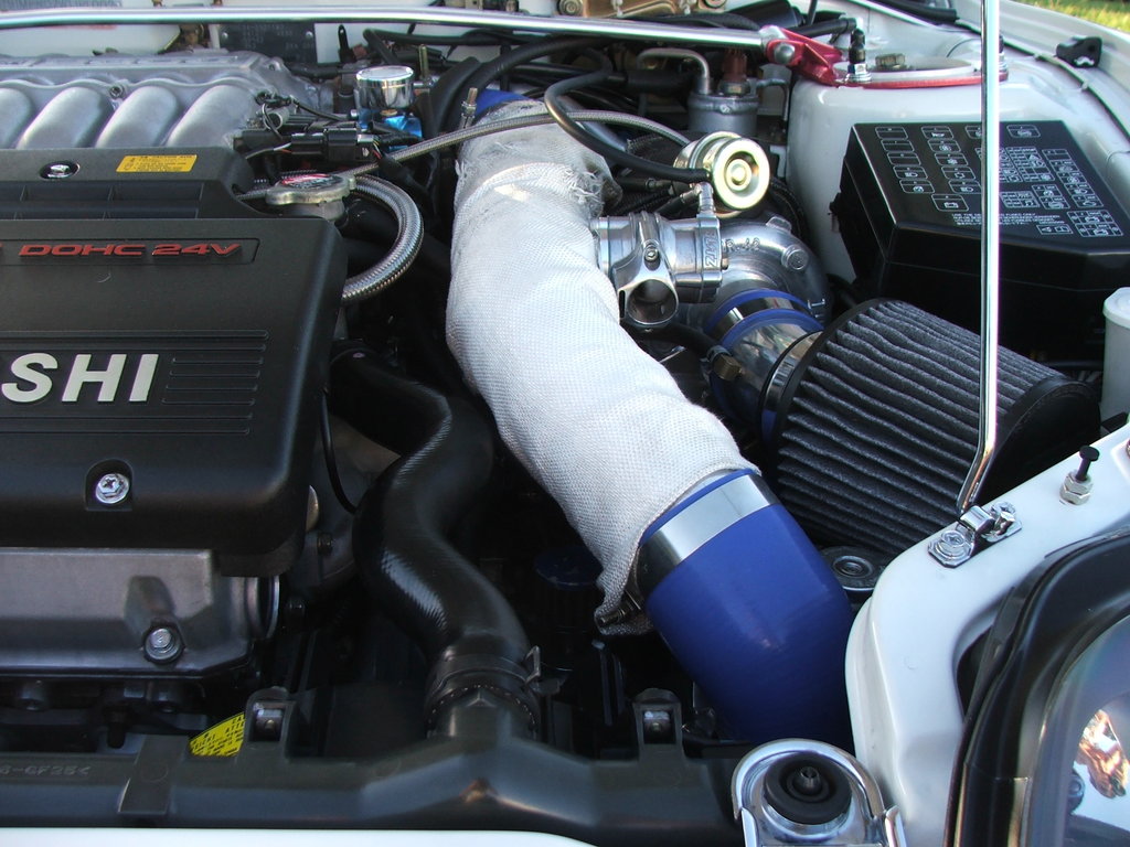

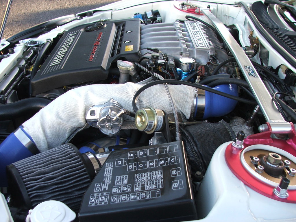

here is my turbo fto :D work in progress ;)
6a12 low comp pistons, forged rods, rpw cams, 560cc injectors, t28 turbo, water to air intercooler, oil cooler, wolf v500 list goes on....

Wow I hadn't seen yours yet!
Gorgeous! :D
Any more info on it anywhere?

no not really.... ive had the car for about 9 years now and still doing it up ha ha it has a small turbo on it atm as i wasnt going to build the engine. making up a fuel surge tank and fuels pumps atm followed by custom plenum, gtx3076r and coil packs...i havent had one problem with the car since i have turboed it! :D what else did you want to know about it?

Does the turbo blanket makes noticeable different to your bay temp?

Massive difference

Super tidy! 8)

yes it is very clean i am the first owner in australia bought it from sydney with 28 000kms with log books was the cleanest one i could find in a year of looking for one. it has been driven it the rain twice in 9 years :cry: yes i heat wrapped the whole exhaust to keep the underbonnet temps down also added 2 extra thermo fans to help. Im running a wolf v500 computer when the inlet temps get too hot it takes out timing and makes it run rich also wont let you boost it over a certain part ive never had a problem with it over heating :D with the heat tape not sure how well it works as i didnt have a before and after to see :?
The engine was broken in on the dyno and was set at a very safe tune. it made 227.9hp atw on 12 psi. i told the tuner EFI performance north yatala who i was very impressed with its not about power at this stage just get a safe tune as it will be up later on to get a full power run as they havent turned mivec on or cams dilled in also running rich liminter was set to 6800rpm. the heads have been ported and polished, on the flow bench they flow 400hp @ 12psi. the comp has been lowered to 8:1 with $600 of coatings on the pistons to run nos and high temps, Forged Con Rods i could keep going and going here :lol:
