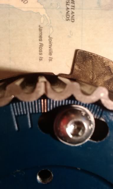

OK the pics are up
and yes the spiders have had there way with them
Oh yeah haha dumb idiots.Bennoz wrote:Ok, so clearly the plate can only go the one way on either gear - so long as its the Mivec plate thats being used. The tab vs the cam locating dowel on the gears are in the same spot.
So if that can't be fucked up, the only thing left that can be fucked up - is the timing belt. My guess, they got the belt out by at least 1 tooth.
Get 'em to redo it, this time making absolutely sure, all the verniers are centred at 0 degrees before they put the timing belt on.
