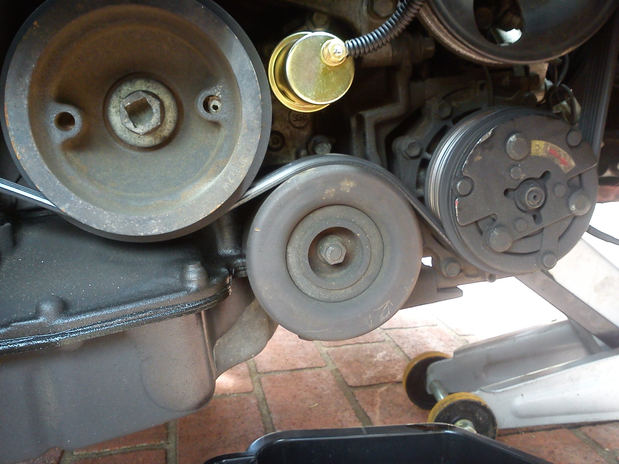

Yeah some of the pressure senders are pretty big. Especially the Autometer ones.

Bennoz wrote: ↑Tue May 29, 2018 9:40 am Yeah some of the pressure senders are pretty big. Especially the Autometer ones.
That is about the size of my one, I'll see how it goes with the sandwich plate and go from there.
That's pretty big (no that is not what she said).
That wouldn't fit on a sandwich plate.
The senders for my gauges are quite small and had no issues fitting

spetz wrote: ↑Tue May 29, 2018 11:50 pm
Spetz can you send pics of your setup or link where you got your pressure sender? I don't want to buy one too large...
