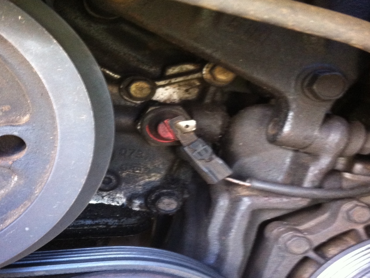

hey guys can someone tell me what this is? sensor of some sort?
noticed it yesterday and looks dodgy

That is your oil pressure switch/sensor.

Super dodge! lol
