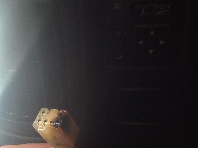

foggies stopped working. fuses and bulbs are fine but this seems abit suspect!(back of the foglight switch)
what caused that? and is it the culprit?
Re: foglights
Known issue. You will need to put a relay for that switch. Check the DIY section, there's a guide for it. :)
Re: foglights
And youll need a new switch as yours will now be burnt out
    Re: foglights
    dstocks wrote:And youll need a new switch as yours will now be burnt out
    Oh yes forgot to add that :D

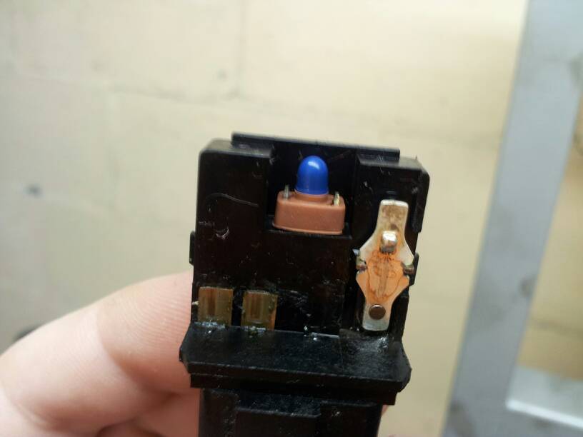

    Actually there is..... its a very small bulb.
    I've opened up 3 fog light switches so far and all have had the bulb burnt out, probably for the same reason the switch melts.
    Re: foglights
    How big is the bulb?
    Must replace!
    Re: foglights
    Re: foglights
    Omg!! I need to replace it!

    Thats the little F%#ker
    i do believe the antenna switch has one also.
    ive been searching the net for LEDs that may fit but have not found anything yet.
    the problem is the resistor and diode that needs to fit in as well because its 12volt.

    They aren't the same as dash bulbs. The switch has two pins, the bulb has two legs that twist around the brown rubber holder. You need a very low profile led, you may have problems with LEDs that have an external resistor.
    Re: foglights
    Vectose wrote:They aren't the same as dash bulbs. The switch has two pins, the bulb has two legs that twist around the brown rubber holder. You need a very low profile led, you may have problems with LEDs that have an external resistor.
    You could install the LED in the switch by itself, and cut the wire behind the switch and solder the resistor there. ;)
    Or use a SMD resistor.
